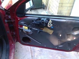

Re: Cabin & Door Mirrors, replace on an S1
I think you're looking for these connectors on the left.
I don't know which is for heated but if you have one unplugged test it with a multimeter whilst turning on and off the heated screen.
I could go and take my door card off and check which one if you like. It's the sort of task I can do right now and I'm climbing the walls with boredom today.
That's the ones...

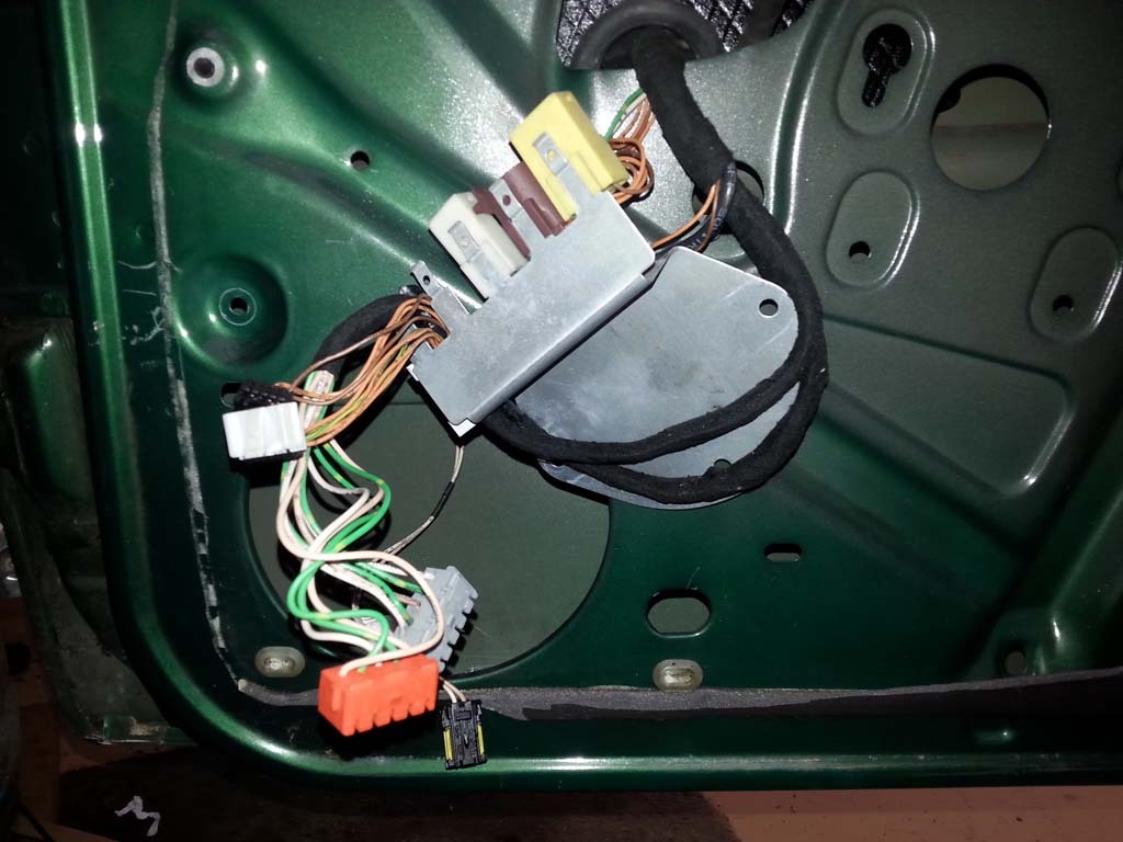

What I have in the S2...
I am sure you are correct re the wires etc if I remember the insides of the Activa doors (it raining so I cannot look atm) there is no large alloy plug holder as above.....I had not thought of the mirror curvature....I can still swap the glass over, the curvature may in fact help me on a left hooker, it may not ?, but I can apply with blue tack and see what they are like
