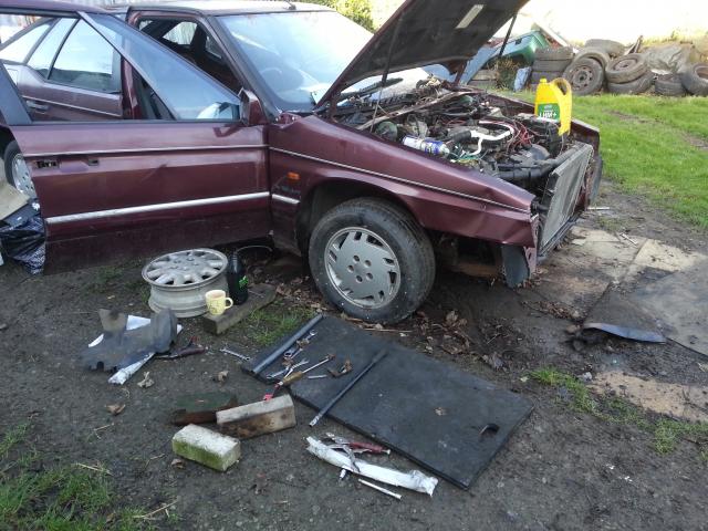

So, the car arrived..
She dont look that bad here. But it was the close inspection that revealed all.
What did we have. Well, a lot of mould on the body, it had stood a long time, laquer lift as expected a badly rusted outer skin on the rear passenger door, and a crazed rear drivers side door. Lovly shiny alloys with ok tyres on them. and a load of bits in the boot.

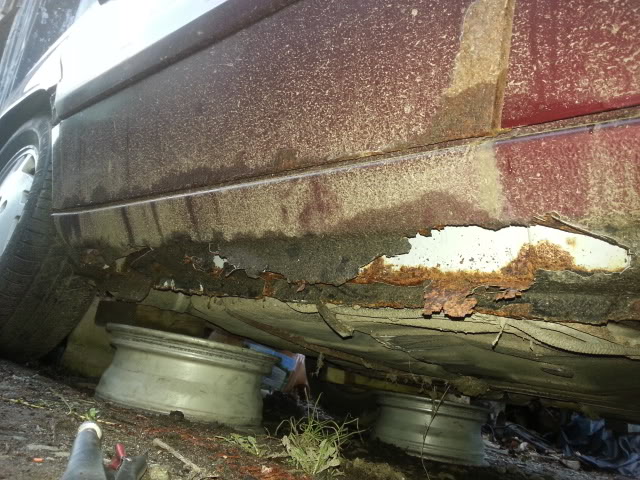

So.. first things first, we needed to see the underside, and hidden areas. front end was already off after engine removal, so I removed the rear bumper so we could have a proper look...

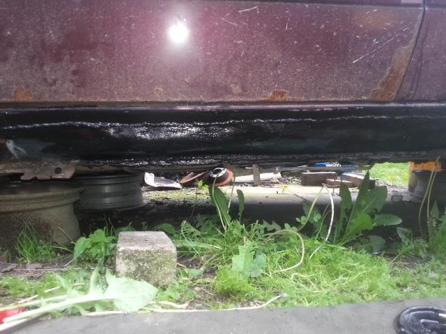

Offside rear Cill.
Off side Front Corner behind Wing Bottom
Off side outrigger behind front jacking point
Near side outer behind wing bottom
Near side Out Rigger behind jacking point
Front nearside cill just below door infront of jacking point
Rear nearside out side Cill
You can see that ALL the jacking points are actually straight on this car. It had suffered a lot of inside out rot. But the question is how!

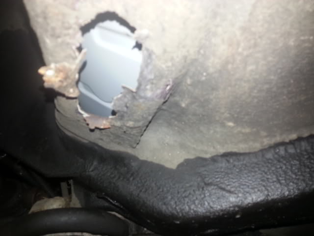

Round to the rear, under the boot floor.
Off side rear chassis leg
Rear near side chassis leg

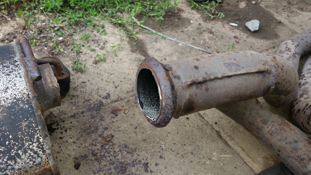

A non standard rear replacment pipe here
Offside rear Cill.

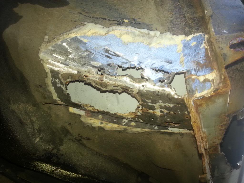

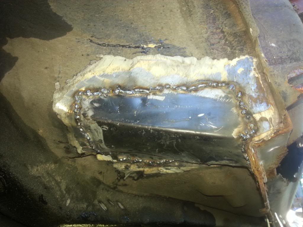

Sooo now we have her running... next we need to sort the rear end out, exhaust off.. which I then discovered the back box was welded to the middle pipe..
Back box trashed so it needed to come off...
Off
Nearside rear chassis cleaned up, well virtually removed!
New part going in
