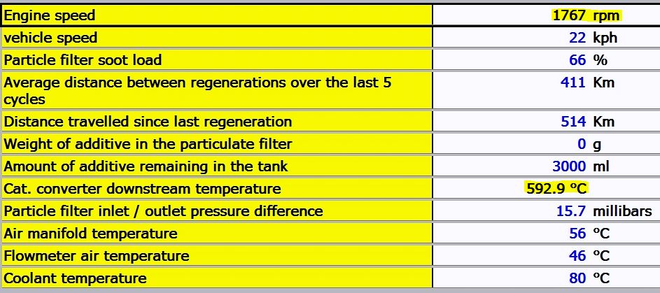

I recorded live DPF parameters last night as I was hoping to catch an auto-regen in progress during a pleasant evening's drive last night as I'm trying to observe the "tells" of a regen in progress.
What I found during appx 1hr's drive, was the exhaust temperature appeared to be highest at lower rpm's and cooled down at higher WOT rpm's (ie, accelerating hard to national limit).
ie.
Note Soot Load is up to 66% so it possible a regen was in progress.
ie.

I haven't noticed my BSI clicking though I mostly have the radio on (or passengers continuously talking), Richard.
I think the exhaust temp is the best tell, though i've yet to confirm the regen was in progress when I recorded the above. I'll compare the temperatures after the regen has shown to have completed, which at 66% soot load, should be imminent.
I was hoping the trademark 2krpm hesitation would prove to be a result of auto-regens (it troubles me a lot) but since carrying out a forced regen, it's not been as big a pain as it can be. Coincidence? Too early to tell but fingers crossed.
Another thing I noticed from the parameters was the air manifold temperature was largely 10degrees or so less than the flowmeter air temperature - until the end of the drive, as shown. Assuming the former is at the mixer (where it controls the mix of intake, egr and intercooler airflows) and the latter at the MAF, the values didn't quite make sense to me during non-regen operation.
