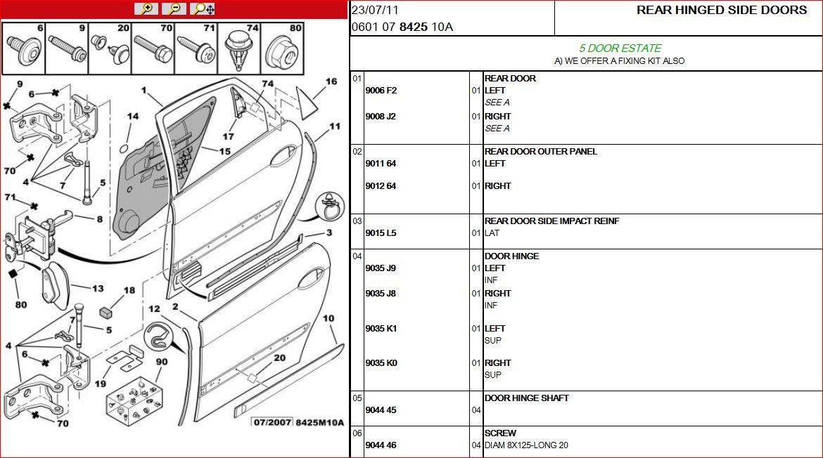

wurlycorner
- Posts: 2177
- Joined: 30 Oct 2012, 22:37
- x 271
Re: Removing passenger door, C5.
As it's turned out, no difference to the way the rear door attaches, anyway

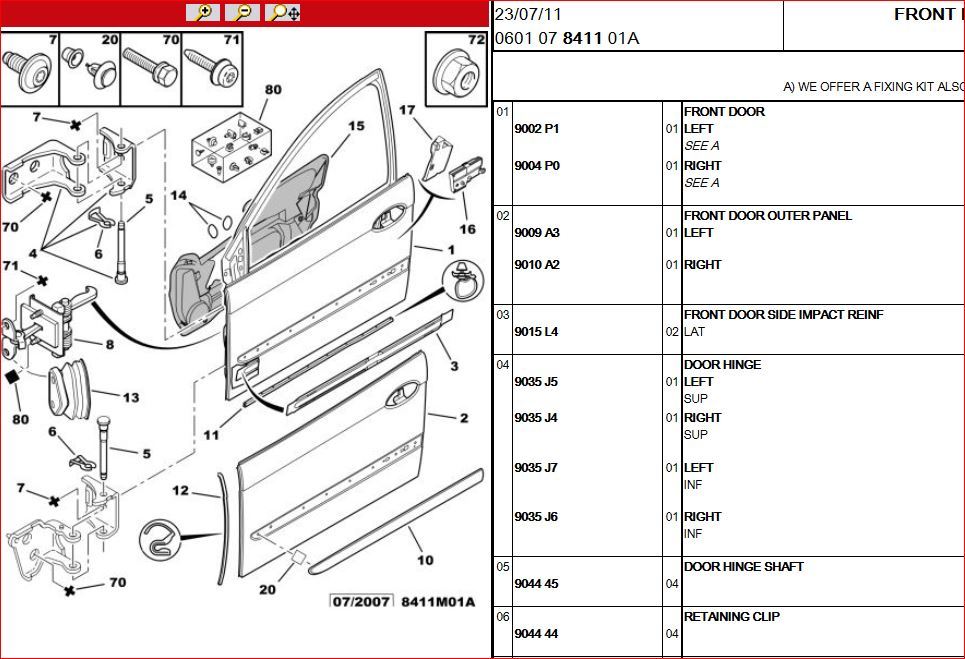

Hi, thanks for the replies. It's the front door on the passenger side. I think the most straightforward way would be to remove the hinge pins, but they seem extremely snug, and have no kind of bolt on the head, they are just smooth. Has anyone had to remove these before? Is it just a matter of hammering them out? Would it help to apply heat beforehand? Thanks.
dnsey
- Posts: 1538
- Joined: 20 Oct 2004, 01:39
- x 19
As Sticky's diagram shows, they have a 'blind' head on the top, and a clip on the bottom. Remove the clip and tap the pin upwards while supporting the door. You will need help, particularly to refit - doors are heavier than they look, and have an annoying attraction to the wing edge if not carefully controlled!
