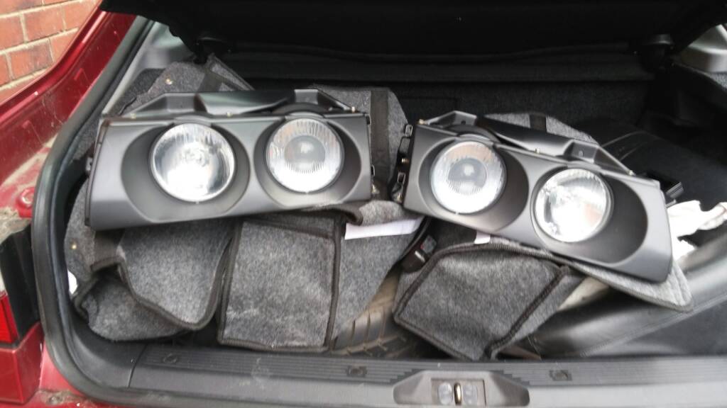

Here's a pic of my S1 Morettes which live at the back of my shed ...
I bought these a good few years ago when i purchased the Activa. Maybe one day they'll finish her off just nicely. Sticky ... that link in previous post seems to point to S1 lamps not S2. I'm not sure they ever made a S2 conversion so if i ever get around to fixing up Activa no2 which is an S2 i'd need to swapover the front ends if i wanted to fit the set that i've got. I'm hoping this is a possibility?

I could print a similar casing , have to be 2 or 3 parts though.
Any chance of pictures from each angle Mike? Would help with inspiration.
Would adding DRL's ruin a Xantia? I can't decide, I like the idea of recessing the leds behind a honeycomb so they're hidden and not dazzling.
£70 for the lamps doesn't seem to bad. Its hard to tell but I guess £20 for the plastic, got to cad something first to get a volume really.

A second look, I think you are correct about them being for the S1.....but not at that price
I would love to make a soft (no damage) mold of those mike, it would make life easy regarding getting a halogen projector light unit made up to fit the S1 as well as the S2 car.....legal as well.
I would be nice to keep a clear glass cover type as well to keep the original look.
I would like to get a set-up designed that used reflectors from a car that can be obtained in a breakers yard/ebay because overly expensive after market ones or HUD would be more than some cars are worth for a set of x4
