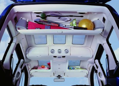

I actually had to search to see what Modutop is ...
... we call it differently here ...
IMO, that's far to much space to put (potential) flying projectiles above your heads

The modutop is a one piece module that goes in the roof, it doesn't open like a sunroof but has five small windows in, and a load of cubby holes/storage. Ideal for travelling with the nippers - miniOptix and microOptix seem to need a lot of accessories.
Trouble is that it seems the bonding/seal around the edges of the modutop can break down, which lets water in. To get it properly fixed, the modutop has to be replaced, i.e. the old one has to be cut out of the roof of the car... such a difficult job that even dealers aren't allowed to do it. Effectively it would write the car off.
I don't mind sealing the odd bit here and there, but the internet suggests that it's not that easy.

I found the Modutops really made the car so much so that I wouldn't buy a Blingo without one, but having said that I bought them both from brand new and never had the issue with leaks which could change my opinion. Both of them rattled and squeaked quite a lot but I found the secret was to loosen the front end securing screws then wedge in a bracing piece of sound deadening/rubber between the CD holder and the roof sorted it out.
