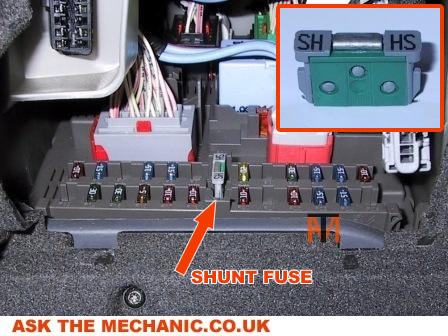

Check the shunt fuse for a good connection...(like this if you have one )
Do you have a Lexia unit to view fault codes ?

Problem solved. The SH fuse had 2 positions. 1- client and 2 parking. Mine was on parking.
