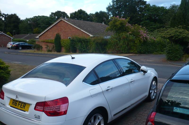

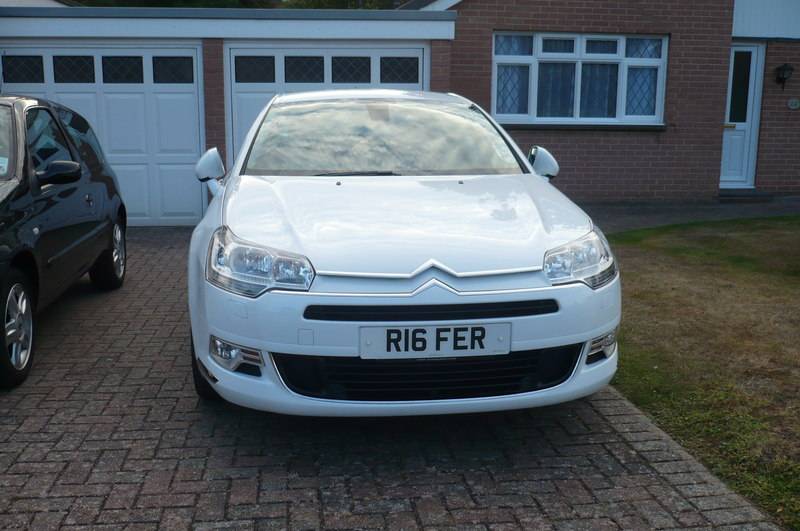

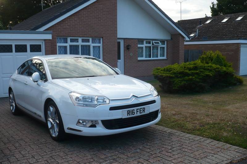

Just finished giving it a good valet and it is just sooooo comfortable to drive and I love the way it looks, but I dread it not starting when I'm out and about with swimbo.
SWIMBO's Clio (My rescue car)
sitting next to the C5
