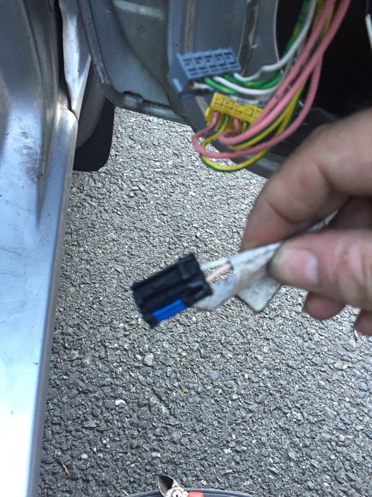

Evening Guys.
Electrics to windows failed on the S2 a while ago.
I have removed and repaired the loom in the door jamb.
However, I am left with one wire and cannot feel where it connects to.
Answers not on a postcard please!

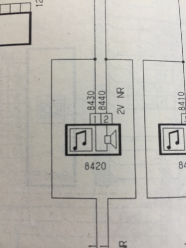

Right! This is the baby. Finally found it
It is the buzzer connection for when the key is taken out of the ignition. It explains why it was beeping.
Question now is... where is the connector located in the door?

Or maybe it is just the speaker wire! Lesson learned!

Just a minute late!
The door buzzer in in the dash, set off with the door switch in the pillar. That speaker plug is used for speakers from about 1999 onwards, before that they were a chunky yellow style
