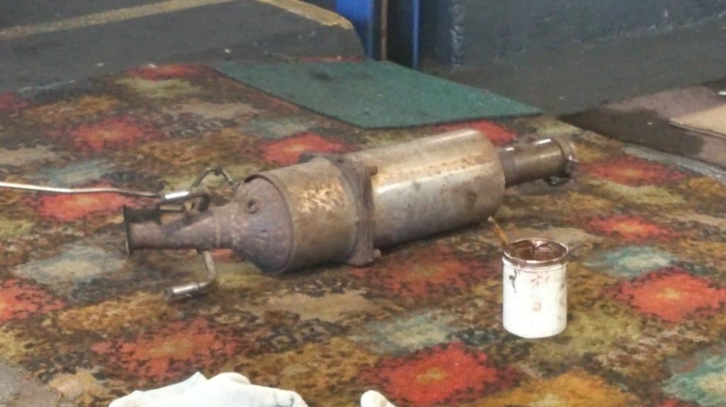

Well used to this message on my 2.2 before i got rid of it, the DPF is blocked. You need to get under the car on a ramp and take the DPF off and chuck a bottle of acidic wheel cleaner into it. Allow it to sit for 10 minutes and then jetwash out the honeycomb of all the the soot/carbon deposits. Allow to drain and then put back on, you'll notice the message will go away after a few restarts when the pressure sensor realises the DPF can breath again.Bandit12 wrote:

A lot of short trips/town driving will block the DPF in 6 months and less than 6k miles, only sure way to keep it clear is regular motorway jaunts. The DPF can be taken off with exhaust still in situ, you just need to undo one clamp each side and a couple of pipe unions you can see coming out of the left hand side. Its worth getting a couple of new clamps cos they have a habit of the bolt shearing off because of the contant heating/cooling cycles it goes through. The DPF splits in half after you undo the bolts to get access to the honeycomb section.

I'm using the proper Mobil oil recommended for the 2.2 and changing it every 6000 miles along with the oil filter. I have topped up the EOLYS tank with PAT1 fluid but struggled to reset the counter. The process is quite involved requiring adding 6 litres of diesel into the tank, switching engine on and off etc all in an exact order. I'm not confident I have done it properly. Car is used mainly for long trips to lincolnshire to see my son each month but also short trips to asda for weekly/monthly shop. Car standing outside house 3 weeks out of 4.
I'll get some clamps and remove the filter and see how it looks
Bandit

Probably the easiest way to try and clean the DPF is to use the Normfest DPF cleaner (Euro Car Parts sell them for £25 at the moment). Get under the car, remove the DPF pressure sensor, spray the cleaner inside the DPF, replace the sensor, start the car, take it for a long drive and watch the huge cloud of smoke behind the car. This supposedly removes the Eolys and ash buildup from the filter.Bandit12 wrote: One annoying fault that keeps cropping up is the message "please clean diesel filter as soon as possible" coupled with "engine anti polution fault" and ESR faulty" Service light also pops up. It does this if I'm going up hill on motorway or going from 40 to 70 limit etc. Really any occasion where I need to put foot down. However stopping engine and switching off car for a couple of minutes and it all goes away. DPF tank is topped up and new battery fitted last year.

That kind of negates the idea of having a dpf. You just chuck all the crap at once instead of a trickle. I remember my trusted mechanic cleaning the one on my first c5. Took it off, blasted it with an airline. I think it took about an hour for his workshop to clear lol. 80000 miles of emissions in 5 minutes[emoji23]GB wrote:Probably the easiest way to try and clean the DPF is to use the Normfest DPF cleaner (Euro Car Parts sell them for £25 at the moment). Get under the car, remove the DPF pressure sensor, spray the cleaner inside the DPF, replace the sensor, start the car, take it for a long drive and watch the huge cloud of smoke behind the car. This supposedly removes the Eolys and ash buildup from the filter.Bandit12 wrote: One annoying fault that keeps cropping up is the message "please clean diesel filter as soon as possible" coupled with "engine anti polution fault" and ESR faulty" Service light also pops up. It does this if I'm going up hill on motorway or going from 40 to 70 limit etc. Really any occasion where I need to put foot down. However stopping engine and switching off car for a couple of minutes and it all goes away. DPF tank is topped up and new battery fitted last year.
