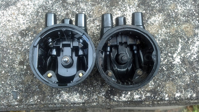

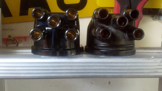

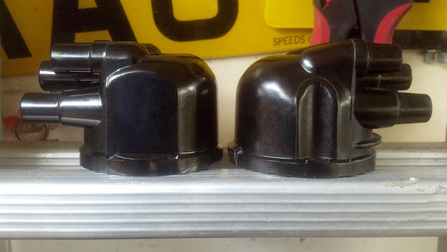

First up was to look at the cap...
Ducellier Valeo D805 (661920) v unknown old cap 1 by macplaxton, on Flickr
Ducellier Valeo D805 (661920) v unknown old cap 2 by macplaxton, on Flickr
Ducellier Valeo D805 (661920) v unknown old cap 3 by macplaxton, on Flickr
Looks like it will do the job, but it ain't the Valeo chestnut colour they used to use. :(

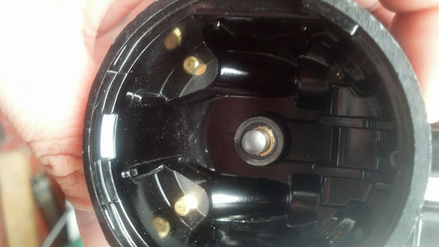

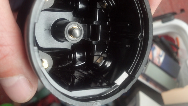

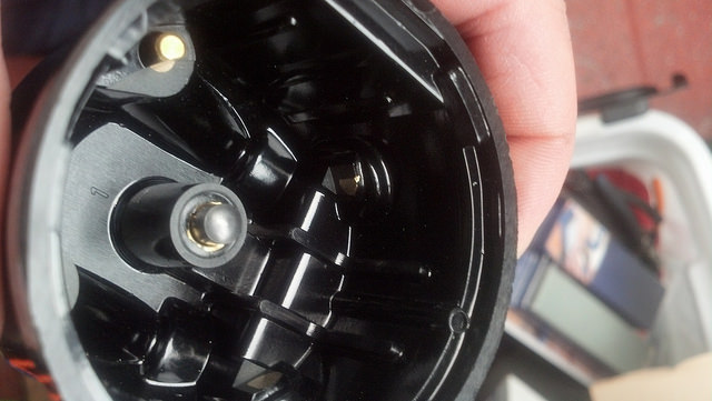

Have a closer look on the inside:
Ducellier Valeo D805 (661920) cap 1 by macplaxton, on Flickr
and compare this contact:
Ducellier Valeo D805 (661920) cap 3 by macplaxton, on Flickr
with this one:
Ducellier Valeo D805 (661920) cap 2 by macplaxton, on Flickr
Bit shonky eh?

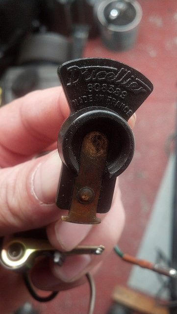

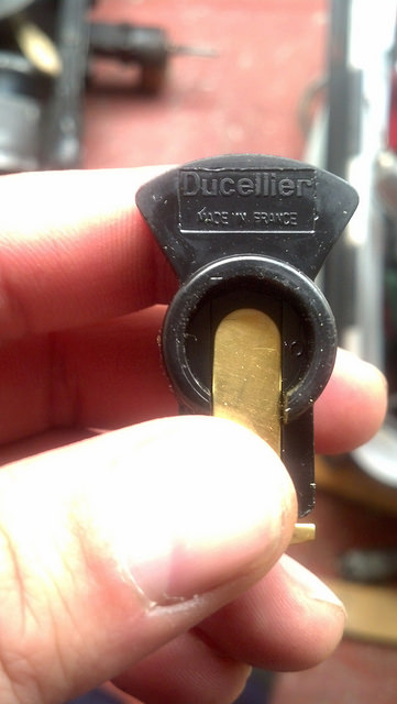

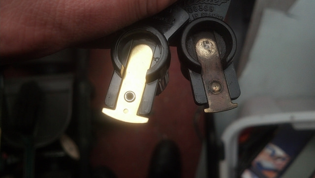

So I try fitting the rotor arm. B*****ks! It don't fit. Well it goes on, but not all the way down...
Ducellier Valeo D903 (608389) rotor arm 1 by macplaxton, on Flickr
Ducellier Valeo D909 (664225) rotor arm 1 by macplaxton, on Flickr

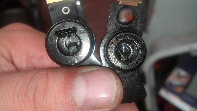

and here's why:
Ducellier Valeo D909 (664225) rotor arm v D903 (608389) 2 by macplaxton, on Flickr
Ducellier Valeo D909 (664225) rotor arm v D903 (608389) 5 by macplaxton, on Flickr
Ducellier Valeo D909 (664225) rotor arm v D903 (608389) 4 by macplaxton, on Flickr
The lug on the newer rotor arm is 4mm wide and the old one 3mm. Now if I read the Valeo application guide properly I would have known that they make no listing for an early rotor arm any more. The early arm fits the 4411B and 4411C. Whereas the later arm fits the 4411E, 4411F and 4411G revisions.
Now if I read my Citroen parts book before I order I would have known the cut-off date for the change over was 6CV 2/79 and 7CV 7/78.
So now I know that one cap D805 fits all, but there are two arms D903 (3mm) and D909 (4mm) (Never mind SEVs and GSAs). Valeo don't do a D903 any more, so it's either alternative supplier or hunting NOS.
The early combo set of cap and rotor is D109 and the later combo D103 (again NOS or alternative supplier)

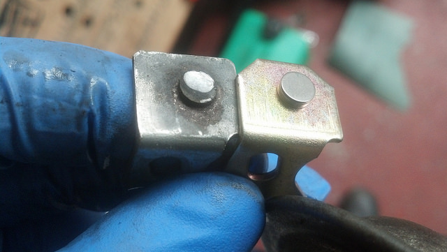

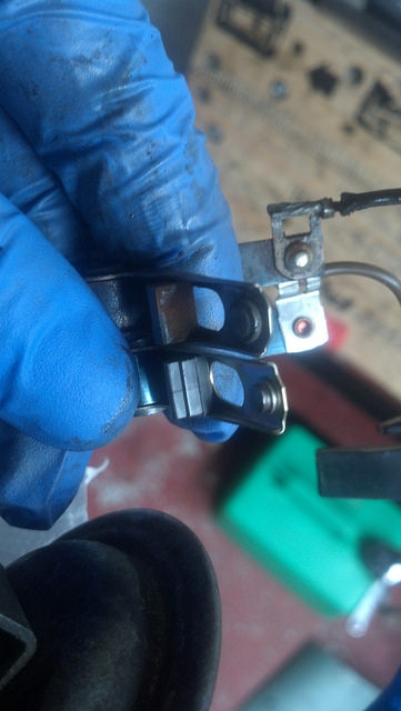

Next up was the contact set as it was looking a bit grim when I was last messing with the dizzy in the middle of a night.
This was looking more promising:
Old fixed arm contact v new Ducellier Valeo D338 (121509) 1 by macplaxton, on Flickr
Old sprung arm contact v new Ducellier Valeo D338 (121509) 2 by macplaxton, on Flickr

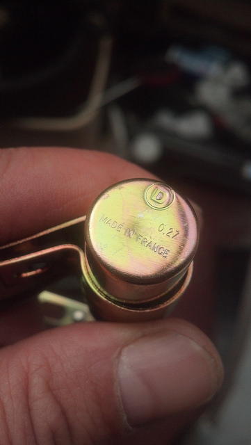

At least the bits fitted, although I found the green wire from the new condenser rather long.
Ducellier Valeo D707 (343707) by macplaxton, on Flickr

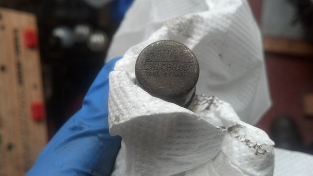

So I got the car fired up with everything but a new rotor on it. Ran okay, so got Mrs MacP to swap cars in the drive. Once she got in her car I couldn't move the car out of the driveway. Why? It was running like a pile of poo and stuttering all over the place. So after taking the distributor back off and checking a few things decided to put the old faithful back on.
Ducellier (609504) condenser by macplaxton, on Flickr
Then the engine was running sweet as again. I think I managed to get about 1 minute out of that new one.
