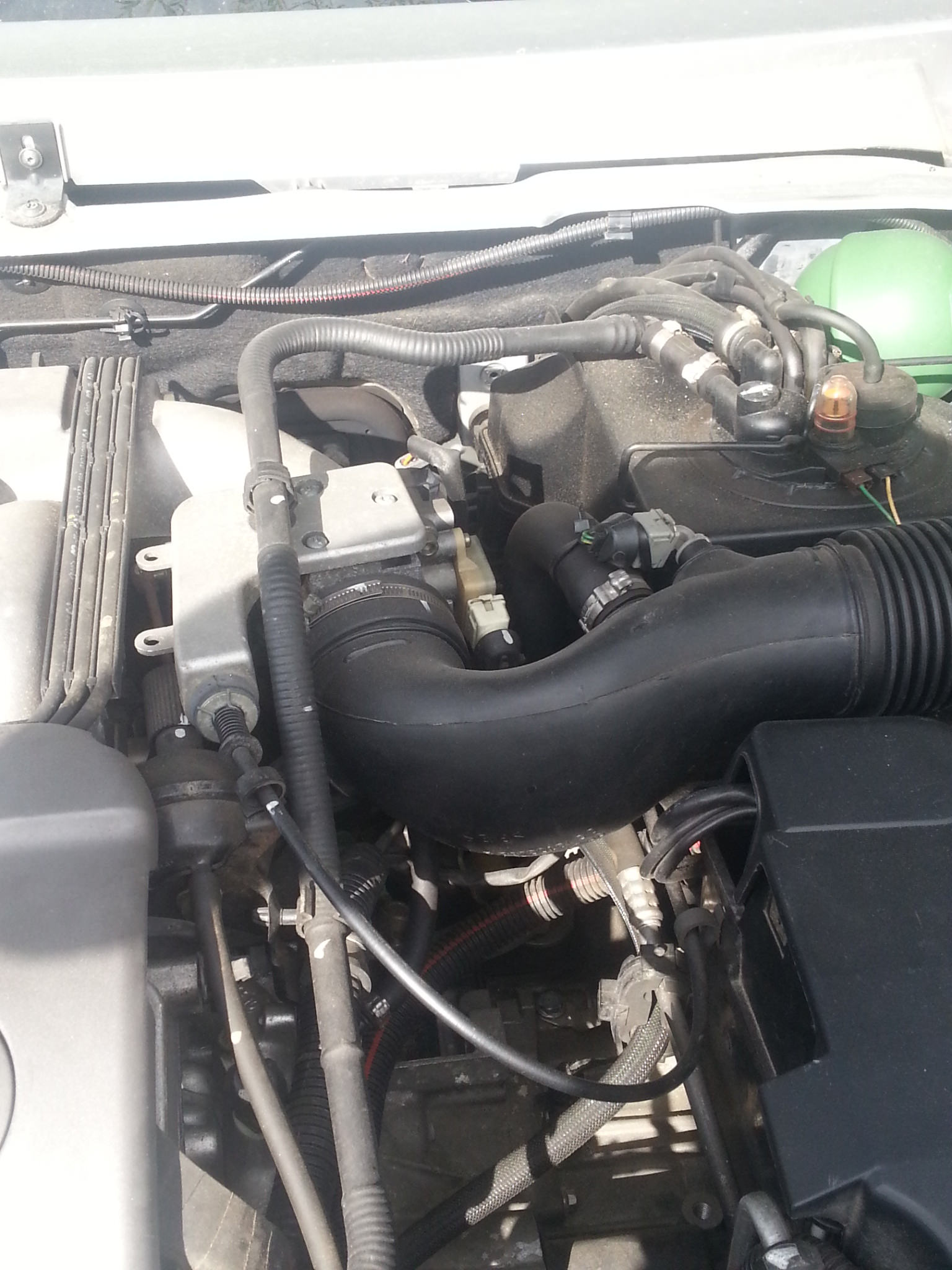

Can anybody take a photo of the cable end mount in the engine bay for me.....I not sure about mine being correctly fitted.

It is the cable end to the throttle body I need a pic of, I "thinks" there is a washer or guide nipple missing, also looks like a "clip" is not there but I would like to check on a standard setup.

The cable comes in from the firewall between the engine and the drivers side strut top, along the side of the ECU box (should be clipped into two clips on the box) curves around and is clipped to both ends of the radiator then curves towards the throttle body.a few inches before the throttle body the cable should be supported by a plastic clip.
So basically the cable follows a J path, and shouldn't be bent too abruptly particularly at the ends of the radiator otherwise I can see how it might bind a bit.
If you're desperate I can take some photos of mine tonight.

Does this help?
No, but this does:
20150603_092019 by v12mike, on Flickr
Had a look in my Flickr account - you need the "BBCode" from the "Share" menu.
No, but this does:
20150603_092019 by v12mike, on FlickrHad a look in my Flickr account - you need the "BBCode" from the "Share" menu.

I an sure it would do if the link workedxantia_v6 wrote:Does this help?

First time trying to link to flikr, not sure hat I have done wrong. PM me an email address and I will forward a picture.Stickyfinger wrote:I an sure it would do if the link workedxantia_v6 wrote:Does this help?

Right click where it says "image" and then "view Image" to see it.

Yep, that works.....my cable "screw" (the one with the stop clip on it) comes out as far as the clip mount which in turn has no clip on it......seems like I need to adjust it somewhere.
