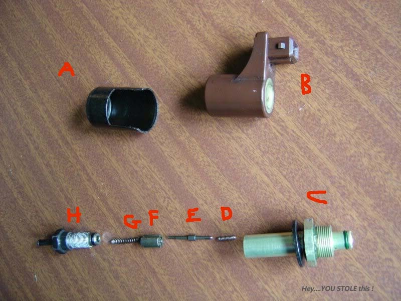

I cannot get I cannot get H out of C to release the shuttle parts......................I am now in great danger of destroying C in the process
Tricks ?

I would leave it soaking in diesel overnight, to see if that loosens things up.

Its been Plus Gassed for a week now (off the car)....not shifted it

Gentle heat.
hairdryer or oven I guess. Not tried it yet myself but apparently its a game of chance as to weather you get in or brake it as I guess you're already finding.
on most things at the moment it seems as I just had another go and its buggered the base............SH173

They need a fair bit of heat to soften the threadlock. One of the advantages of Hydractive 1 system (the only advantage?) is there's only one central control valve that doesn't tend to go wrong.

The opposite might be more appropriate for metal and plastic assemblies. Try chucking them in the freezer overnight.

Guys....it is only the LONG thread on H into C that is causing the problem.....that is alloy to ally with a thread lock paste of some king by the look.....the "grip" is too much for the thin (soft ally and corroded) head ring which is about 4mm wide.

Are you using open ended spanners, ring spanners, 12 point or 6 point sockets?
Tried mole grips? I tend to use these on stubborn old brake lines. Took a few practise ones to get the 'feel' just right for not crushing the nut but being tight enough that it won't slip, but pretty deft at it these days.
