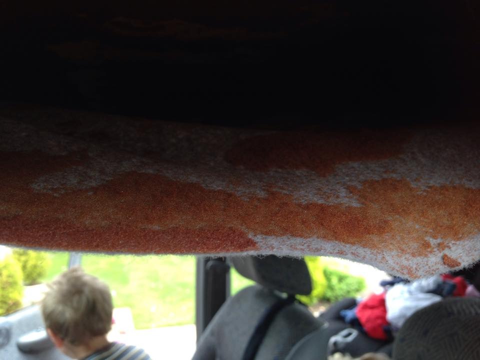

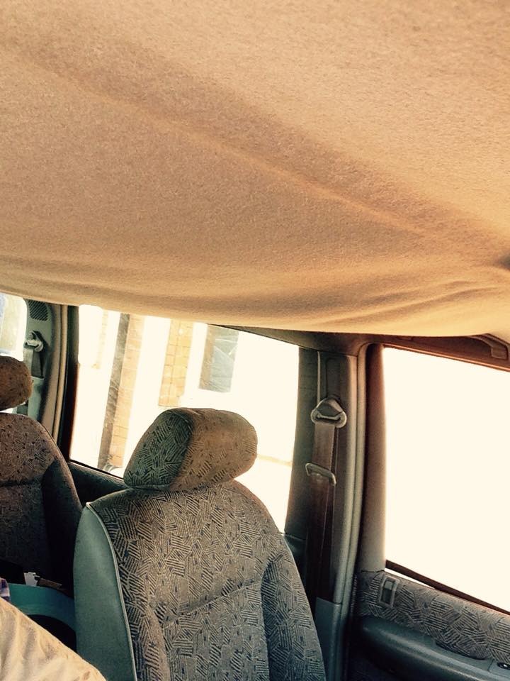

Just wondering if anyone knows what would make the roof lining (a felt material) stick back up?
A week or so ago the heat became too much for the old glue and it's come away from the hard board thingy...
I tried some glue but to no avail. I've now bought heavy duty carpet adhesive (as well as a cool looking gun applicator) off flea-bay.
Got a few photos to post of the problem. I have taken down one hand rest (front passenger side) and aim to gun it in from there instead of pulling every corner off.

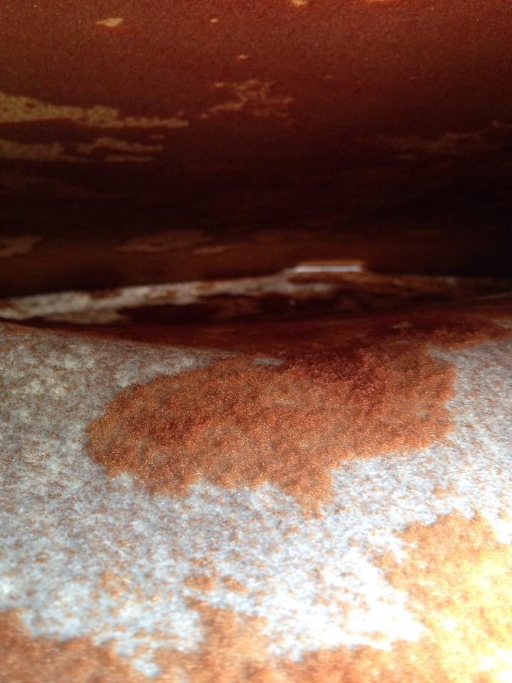

The brown stuff is the horrible factory glue.

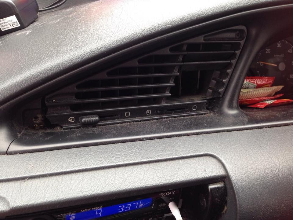

Also replaced the front vent surroundings, it was cracked in a few places...

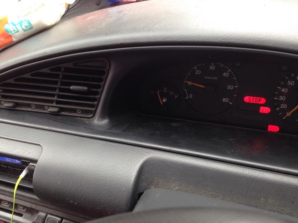

Looking at your rev counter, I would say it is a bit fast on idle :), I like the Tomato ketchup stored up ready....but that DUST looks like the inside of an old carpet living PC, that would drive me mad.
My only concern is the adhesive getting soft in the heat, this is designed for the job.
3M trim adhesive, heat resistant, long open time....other makes can be found on EBay

thats the exact same ting my daughters P reg Synergie suffers with, she has attempted to stick it back up several times, with various aerosol adhesives,
you will need to scrape all the stuck on remains of the head lining foam backing ( that orible crumbly stuff still up there ) off if you are going to have half a chance of sticking the lining back up,
the crubly stuff is not just the old adhesive but also the backing of the lining material,
i think carpet glue will permeate the lining and look even worse,
after cleaning the inside surface of the roof you could try double sided carpet tape, as that stick like the proverbial to anything
Regards, malcolm.
Posts: 11837
Joined: 28 Mar 2013, 21:05
x 1994
Re: Synergie Roof Lining question
Unread post by Stickyfinger »
The big problem is not the glue, it is the foam coating that has oxidised and is turning to powder, there is little chance of tape working on that substrate, a spray may "coat" a sufficient area to help it grip.....The only real way would be take it off and clean off the foam and all its dust, apply new (its cheap) foam and then reapply to the carrier.......or find a clean one in a scrap yard

citronut wrote:thats the exact same ting my daughters P reg Synergie suffers with, she has attempted to stick it back up several times, with various aerosol adhesives,
Oh no - not that horrible brown stuff! How could I best remove the old adhessive and backing material? Really didn't want to have to take the whole thing down lol... Is there any easy way to get the hand rails off, I managed okay with the one I did, but they have some screw covers on and i don't know an easy way to access the screws?

PugLover wrote:
, I just thought that some carpets have under floor heating..
maybe so but carpet doesnt usually sag as its laying on the floor :yikes: #-o :-D :lol: :rofl2: :rofl2: :wink:
PugLover wrote: Oh no - not that horrible brown stuff! How could I best remove the old adhessive and backing material?
i think she used a scraper, her lining was hanging down all the way across the back end, so she had access
PugLover wrote: How did you manage to do your daughters?
she hasnt finally stopped it, but i think she is going to try double sided carpet tape next time she has a go at it
