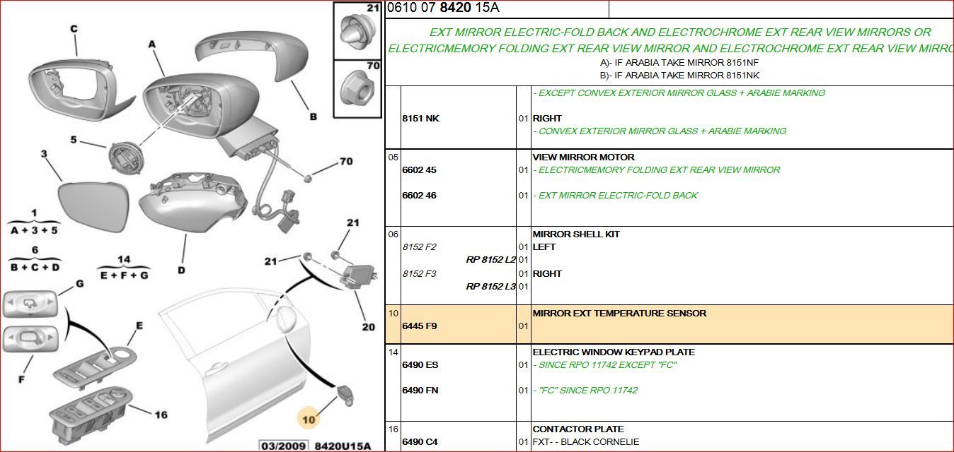

Not sure of the exact car you have, but this is I think the part you are looking for (10), it plugs into a connector in the mirror body.
00006445F9 MIRROR EXT TEMPERATURE SENSOR 26.13 GBP 31.36 GBP incld VAT
Note: check by your VIN before ordering.

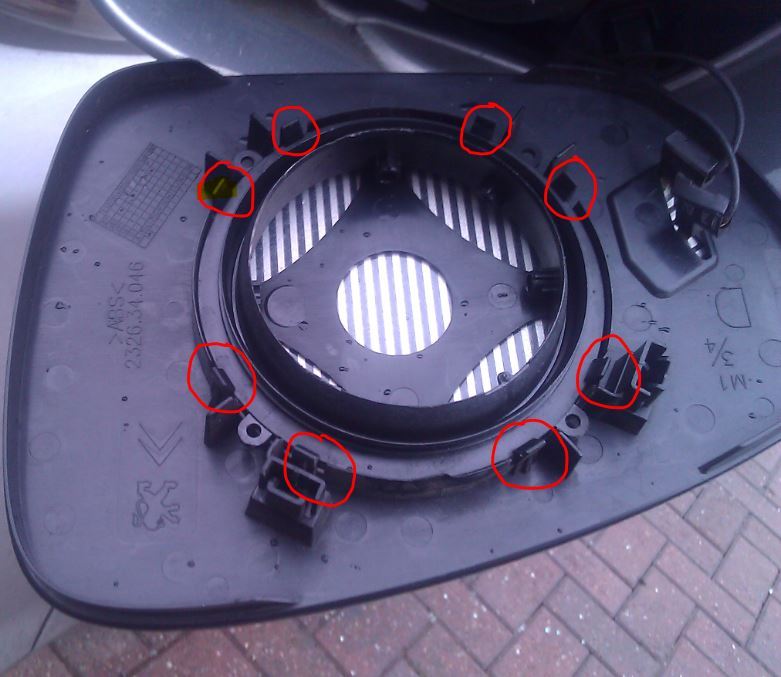

Re: C5 tourer temperature sensor problem
have a go yourself, it's not that difficult.....
the 8 clips are marked on here...
couple of small thin screwdrivers/bradawl type tools should do the trick, you want it to look like this if correct....
...well at least the back of the glass anyway, the ring on the right should be bigger with the motor attached to it
you've got the sensor cheap, glass can't be that much and even if you screw up like me with the motor @£68 at least the stealer hasn't had £99 off you to check something that Lexia won't anyway?
