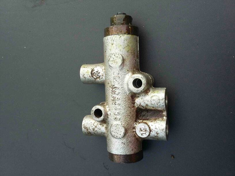

I would think the most likely faults would be the rear suspension rams. You should check the flow rate in the LHM return lines.Northerner wrote:Right down ...
superloopy
- Posts: 3344
- Joined: 30 Mar 2005, 03:25
- x 19
Re: Xantia sinks like a stone
Is it likely that both rams would be suspect though? How do i check flow return rate? Is there an antisink valve in the setup?

Should be anti Sink. 1995 and 6 spheres suggests so.
superloopy
- Posts: 3344
- x 19
Yes .. it's definitley NOT a sinker that's for sure but what i meant was does it have an actual antisink valve and if so could this be the problem?elma wrote:Should be anti Sink. 1995 and 6 spheres suggests so.

Looks like the rear anti sink valve is not doing the job its suppose to do
. I suggest to start from there.

Its probably not the anti sink valve as even if that was not closing it should take minutes or hours to sink.

Could possibly be the doseur, it's worth checking that return line as well.
You can check all of the returns easily at the LHM tank

From the doseur there will be two rubber low pressure returns, follow them to the tank, pop them off at the tank end and put the ends in a jar, there should be very very little LHM come out (you might get a dribble as you lower the pipes). Let us know what you find.
