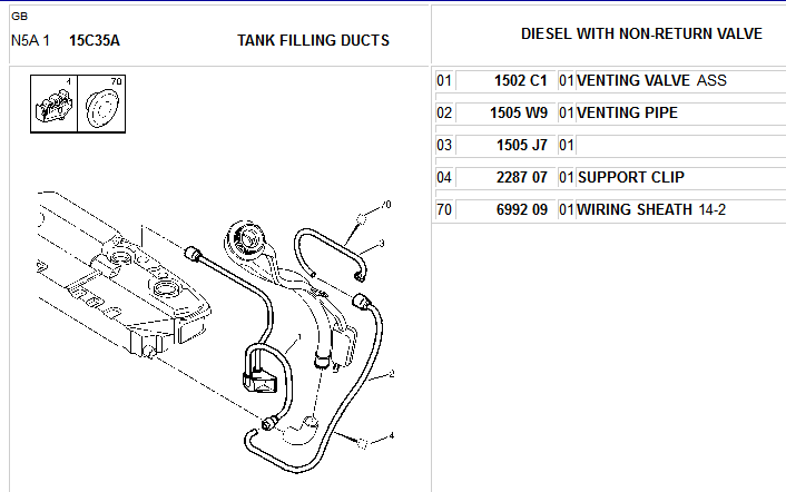

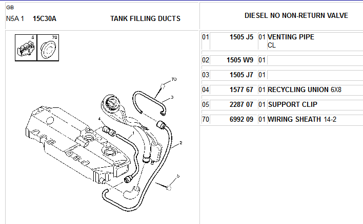

im sure you may have already sent me your cars chassis/VIN No. before, but i dont know were it would be,
so if you send me it i will get you a screen shot of your tank vent system from pug service box,
on the two i looked at it seems the tank vents into the top of the filler neck just below the cap, this suggests to me there will be a vent hole in the cap, it could well be concealed

Re: Fuel vacuum cap breather 306 hdi
Seems to be vented (diesel models only obviously!) via the pipework. Choice of two, either with or without a non-return valve although they do not look too dissimilar:
306 Diesel N5 WIthout Return Valve:
306 Diesel N5 With Return Valve:
For what its worth I looked at the old shape ones out of interest and it seems only the early ones vented via the cap (as there appears to be no venting hose) but later first shape ones have an almost the same setup as the newer shape ones.
It just lists Diesel / Petrol etc for the new shape there's no distinction with engine type ie DW8 / XUD9 / XUD9T / DW10
Andy.
