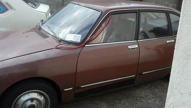

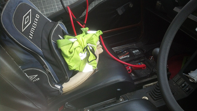

Having jump started the car, I get the first leg of the journey to the motorway done. Then I have the sinking realisation that the battery ain't charging. Please get me to work, PLEASE. Get half-way there before the engine stops sparking and coast down a slip road to the bottom. Out with the small socket set. Grill off, yes the belt has gone on holiday. Spare belt in glovebox. Have a stab at fitting that, but that idea quickly went out of the window when I couldn't slacken off the 13mm nut on the alternator mount. Only had a 11mm spanner with me, the rest was all 3/8" drive sockets. Bugger! I didn't even have a 10mm for the battery terminals, nor even a crappy adjustable.
But I did have two battery in the back and I did have my jump leads....
IMG_20150522_174907_294 by macplaxton, on Flickr
IMG_20150522_175040_578 by macplaxton, on Flickr
1½ hrs late, but fortunately the schedule was recoverable to a reasonable degree.
At least tomorrow is not a week day, so it'll be a Honda day. :twisted:

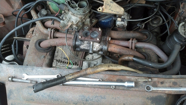

Did this job in the "comfort" of the driveway.
What is this correct spanner you speak of Vince? I just got the 3/8 drive socket out (which I had with me the other morning to get to the bolt head. Normal spanner was fine for the nut, although I can see it being handier if it were cranked. For the nut & bolt on the adjustment slot it was easier with a pair of 11mm spanners.
As far as putting the belt on, I started back-to-front, putting the belt over the fan blades first, then spent I while cursing through one of the wide slots trying to get the belt hooked over the alternator pulley. Got there in the end, but I was using a Gates belt that they felt was a good idea to fold up into the cadrboard sleeve :evil: so it wasn't initially straightening out as preferred. Belts was a shorty one a 613 I think.
Does the GSA have a larger pulley that necessitates the slightly longer belt? (625?)

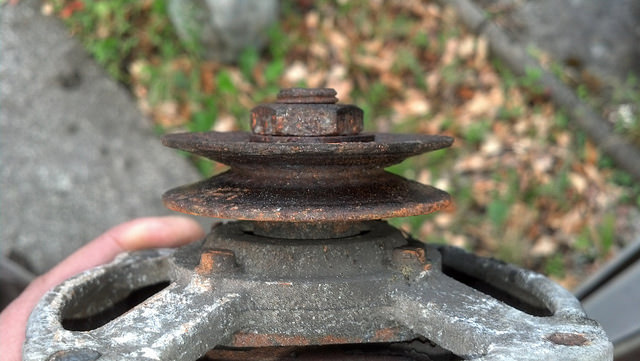

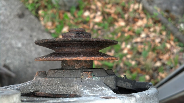

The alternator would move, but not remove without getting the airbox/carb out of the way :grr:
IMG_20150726_185855_243 by macplaxton, on Flickr
Pulley looks grotty. Done what I could with a wire brush, but could probably do with a new pulley.
IMG_20150726_185925_955 by macplaxton, on Flickr

if you were to use a 12" metal file Mac :wink: you need to get that pulley back to bare metal :) ( After looking at your photos Mac ) it is far too rusty in the vee parts where the belt makes contact :wink:
Once you have got the belt contact areas cleaned back to metal, just give 3 or 4 coats of stove enamal ( the black paint they use for repainting multi fuel log stoves ) Mac :)
At least you should be able to get some mileage like that :) I have done exactly the same as the above on quite a lot of the pulleys on my own cars over the years.
