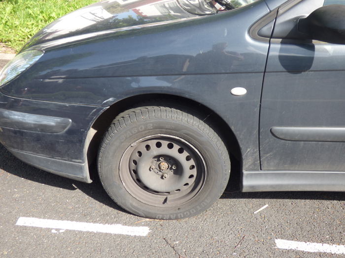

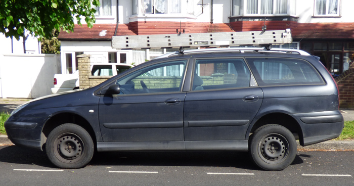

Re: Citroen C5 supsension problems.
The garage is not a Citroen dealer or specialist, but they do servicing, brakes, tyres and exhausts.
I've got some pictures.
With the car in normal engine running
With the car at highest setting
with car at lowest setting
