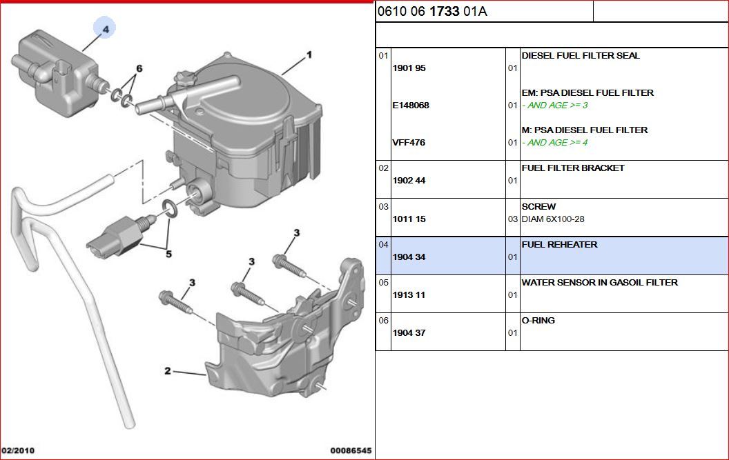

Hi guys I've just took the fuel filter out but it looks like it has melted to the sensor I will upload pictures when I get home as out atm.
Any ideas what the sensor is tho, as I'm stuck as to what I is.
Dan
Dan
- Posts: 11837
- Joined: 28 Mar 2013, 21:05
- x 1994
Re: c5 1.6 59plate trouble starting.
is that the water in fuel sensor ?......or the heater your talking about
Melted ??? FIRST find out why...Melting stuff needs lots of heat, and near your fuel supply IS NOT GOOD
citroenc5mad
- Posts: 110
- Joined: 03 Aug 2014, 19:36
- x 1
Hi sticky that's the beasty, when I say melted It might be a bit over the top, basically the clip that hold the heater into place has 'melted' a little, I didn't want to risk taking it apart and couldn't re use the heater, though it was a sensor.
Dan
Dan
