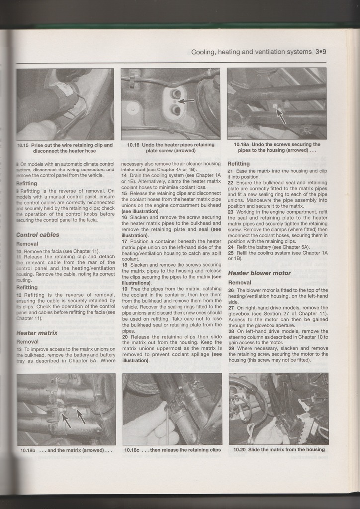

Haynes implies it is easy, as it doesn't mention removing the dash, but in the picture the dash has clearly been removed (probably for clarity in Haynes speak!). The matrix slides into the heater box from the passenger foot well, so it may well be do-able with the glovebox / carpet removed on the LHS. On the other hand, this is PSA!!

Relevant page from the BOL. Pic at bottom right clearly shows the dash removed....!

This thread: http://www.peugeotcentral.co.uk/ftopic-2096.html certainly implies it's possible without dash removal - once you get past all the stupid comments about the matrix being under the bonnet somewhere

This was actually an incredibly easy job! 40 minutes from start to finish
Heater Matrix from AEP for £25 was a Nissens one as well so should hopefully be good.
You take the glove box out (6 torx screws), the carpet above the passengers feet off (3 pop studs), and the plastic part of the transmission tunnel (2 torx screws) and the heater matrix is clearly visible. One screw out of the end of the matrix and the pipes come off. I took the pipes off under the bonnet as well so that it wasn't bending the plastic ones inside the car and the whole thing slid out.
New one went straight in and was refitted! A very easy job! I wish they were all like that!

Nice one! Sometimes the RH drive mod works in our favour (not often mind!) - on a LHD car this would be a steering column out job
