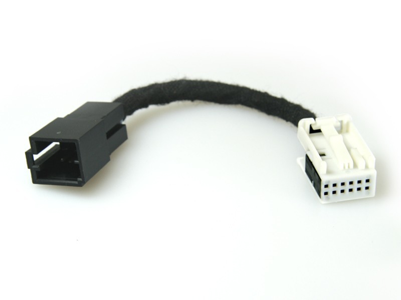

Re: RT 3 Rear Connections
Unread post by vborovic »
The CD connector is part of the quadlock, the smaller connector, below the blue fuse (as on the pic), looks like this (white part):
