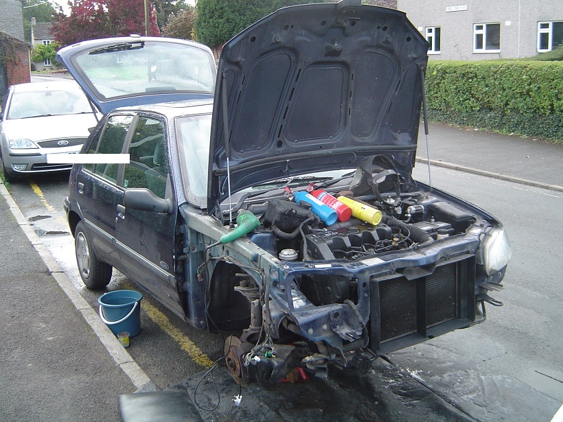

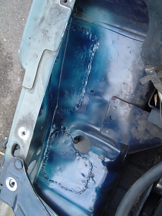

An update, with thanks to all whom contributed to this Thread and for the info of others whom might be in a similar situation.
Today I welded up the inner front wing of my daughter's Pug 106 following an accident, at the roadside using
A Clarke MIG 151 TE (Gas only)
25metres of heavy duty '8 gauge' I think it was extension lead, was a surprisingly reasonable £33 delivered (for the wire only). I fitted a socket and a 3 pin plug
2 home made 'screen's: USB, large Shelf Brackets and 3 x 2 timbers
I didn't need to make any adjustment to the wire or power settings to allow for the long extension cord
If like me, you've no off road facility, it can be done !
Thanks again everyone for your input to this Thread. I got there in the end !!!
