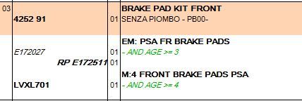

The seller has responded asking for OE part number. Can anyone decipher the Citroen Service info I'm seeing, please? This is taken after entering my VIN
I have no idea what any of it means. :oops:

There are basically 3 different types of brakes fitted to the front of a Xantia, usually recognised by the disc size: 266mm, 283mm and 288mm. The larger is only fitted to 2.1TD, 110 HDi, V6 and later Activas. The 283 are generally fitted to Estates, and higher output petrols, the 266 to the smaller engined hatches (inc yours). There is I think a 4th variant fitted to early Activas only, but that's very uncommon. So you will need the smallest pads offered.
Anyway, back to your pic. The part number is in the LH column. So you start off with 425291 which is the original part number. Then there are 2 options for 'cheaper' parts offered for older cars. The first of these has had its original part number changed, so it was E172027, now replaced by (RP - replacement part) E172511, the second still goes by LVXL701.
If you ask for pads to suit 266mm discs they should be able to sort you out.

RichardW wrote:Anyway, back to your pic. The part number is in the LH column. So you start off with 425291 which is the original part number. Then there are 2 options for 'cheaper' parts offered for older cars. The first of these has had its original part number changed, so it was E172027, now replaced by (RP - replacement part) E172511, the second still goes by LVXL701.
Thank you kindly! =D>
