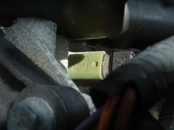

I've cleaned the throttle body with brake cleaner as advised by the garage and I'm now thinking the temperature sender unit may be the faulty sensor and miss-fueling when the coolant is cold. I partially (photo) disconnected the sender cable and drives OK (no dash temperature reading and the radiator fan runs constant and turns off approx 3-4 minutes after ignition is turned off). So it seems to be running as if the ECU thinks the engine is warm ...this is obviously only a temporary measure as the radiator fan would probably fail prematurely and would expect fuel consumption to increase.

In hindsight I think INITIALLY the temperature sensor should have been disconnected to see if that remedied the power loss rather than change BOTH the Lamba sensors.
