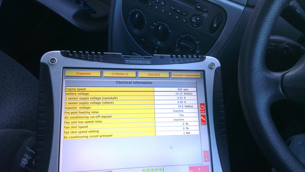

The A/C in the C5 doesn't work (didn't when I bought it). I was assuming low gas, but having now got my Lexia working, I thought I'd try and confirm that before taking it in for a top up...
I'm none the wiser.

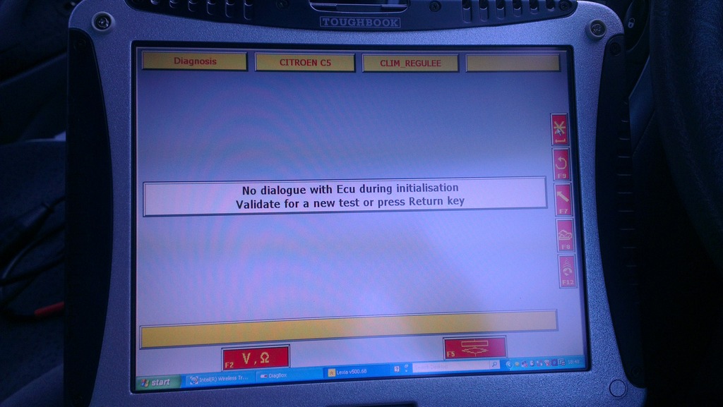

Checking the config of the car shows that it knows it has air-con, but when I do a comms check of the ECU's to try and diagnose when the A/C is up to, it says no communication with the A/C ECU. I assume though that this is normal, because mine has the manual A/C rather than auto?

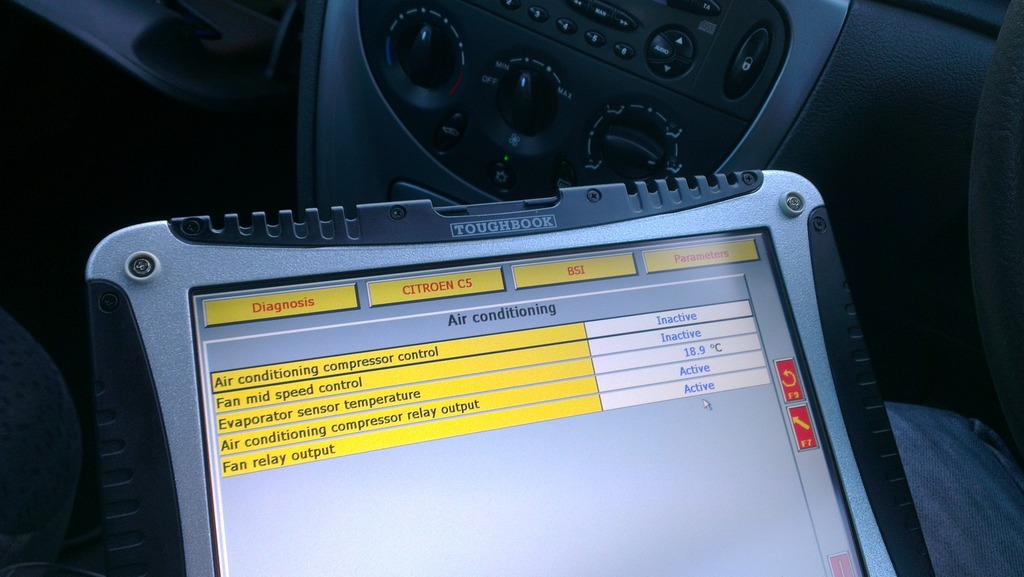

Anyway, elsewhere I checked some of the parameters;
This is with the A/C switch 'on' (as you can see in the background)
Nothing seems to change when I switch the A/C button on/off, although the light on the button does go on/off as it should.

It may well be down on gas which may explain why on the third photo the cut off request is displaying "Yes" but before getting it re-gassed, have a look at the condenser for oily patches on it's surface when looking at it through the front grill (particularly in the lower corners), if it has any then it almost certainly has a leak.

Others will be more qualified to comment but the 1 bar air con circuit pressure sounds too low to me.

Is 1 bar of pressure enough.. dont they need about 5 bar to function efficiently..??

I'm quite sure 1 bar is nothing like enough, it will need to be much more than that.
As I say, from what I can see, the system is doing nothing, not even engaging.

It's unwise to go on circuit pressure to determine the amount of charge, the pressure will vary too much depending on temperature which is why aircon systems are filled by weight. However you could get hold of a re-gas can and put a few extra psi in the system to see if it works but proceed with caution because you really don't know how much gas is in the system and whether the pressure sensor is working correctly.
