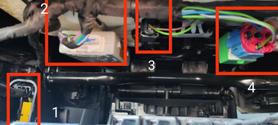

Re: C4 underseat wiring.
Hi,
See attached picture of the underside passenger front seat taken from the back in s C4 Grand Picasso mk2 (2014) 1.6 diesel.
I have numbered the plugs in the picture. Can anyone provide information on any of those? What they are connecting with?
Thanks
M.
Thanks
M.
