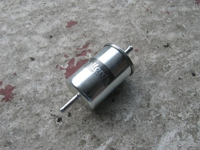

New filter's there's a choice, ensure the new one has a 'rim' on the filter stubs near the filter itself as the ones without are meant for the earlier type with worm drive clips and some suppliers may mix them up "its a fuel filter innit?" etc *sigh*
Unsuitable:
Suitable (note the 'rim' near the filter stubs) sorry its a small pic:
Unsuitable:
