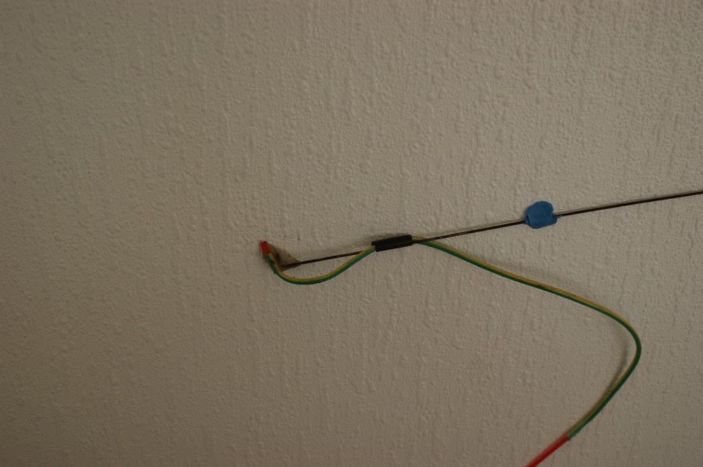

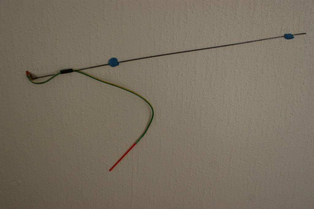

Hello,
I have been plagued for years by Noisy auxiliary/serpentine belt Tensioner pulley's, when the pulley has been replaced
it has been stripped down and greased fully before reassembly, but it somehow dries out again within a few months
and the bearings get noisy again. This noise seems to travel through the whole car it is especially bad when the engine is idling.
I was wondering if it was possible to lubricate the bearings with the pulley in situ and after making up the item in the following Photographs I succeeded in squirting some spray grease into the bearing from the back of the pulley.
The front of the tensioner pulley has a metal plate on it which stops access for lubrication but the back has a small area which leaves the bearings exposed enough to add some spray grease.
I have just been for a thirty mile round trip and the noise has gone, I have just applied a little more spray grease Just to be sure the rumbling noise stays away.
In the photo you will see a length of wire with a right angle at the bottom end stuck to this with aeroldite epoxy is a piece of the Red tube that comes with a spray grease or WD 40 oil can, I cut small pieces of this red tube and pushed it into a length of 2.5mm yellow and green striped mains earth sleeving, connected one end to the sprayable grease can nozzle glued the other end to the bent end of the wire rod and inserted the angled end of the wire rod behind the tensioner pulley as close to the tensioner aluminium body as I could get and I gave this area three short bursts of sprayable grease, left the grease to penetrate and thicken for about five minutes and the noise disappeared when the engine was started.
I hope this helps with anyone who has the same problem with a noisy tensioner pulley, it has been bugging me for quite some time how to get some lubricant into the tensioner pulley bearing. I shall now be able to stay on top of this little problem by regularly greasing the tensioner bearings to prevent the noise returning. photos below.
