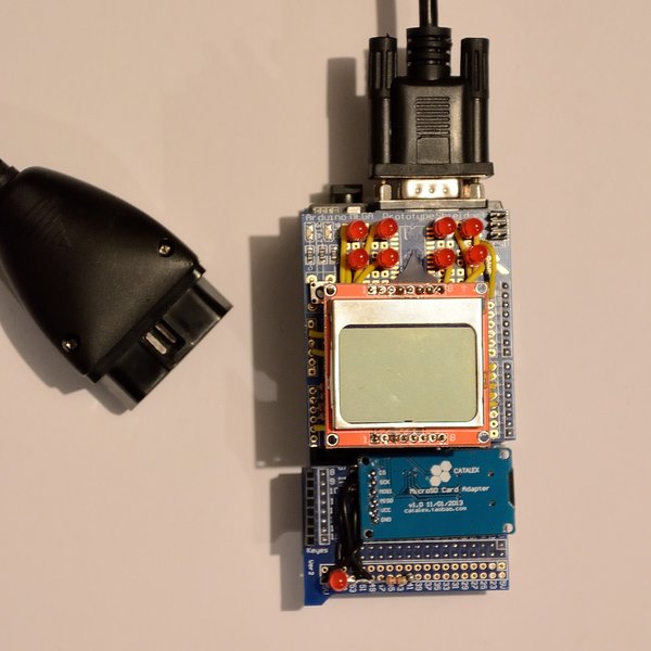

Bringing this thread back from the dead, i abandoned trying to snoop and emulate the usb bus and instead focused on the other end of the diag tool, to diagnostics socket with great success ! it turns out to be quite simple to do, as the data im after is all available over the CAN bus at the standard 500kbps , you just have to watch how the actia tool does it and repeat. Ive done this and have made a data logger and display for the selected gear and gearbox electrovalve readings, but could easily be adapted to any reading available in lexia.
https://hackaday.io/project/12644-can-d ... can-shield

GiveMeABreak wrote:You just need to go into the area you want to monitor - usually the specific ECU, then you should get a sub-menu, Measurements where you can select the particula tests to monitor - I think up to 10 specific measurements at the same time John.
in lexia its only 6 custom parameters, and its pretty flaky at best, i also think it is only meant to record for 5 mins, but ive never gotten more than a couple before it drops with communication error.
my device automatically connects and reconnects if needed, so it can be left plugged in and will do its thing.

I have a project that needs to read engine paramaters from the CAN bus. I'm using an Arduino Leonardo, MCP2515 and MCP2551 to communicate with the bus.
What I have found sofar is that the engine ECU broadcasts a number of parameters on the bus without prompting, however it is not as complete as the data available through the live-data feed in PP2000 using Lexia. Did you find that you need to transmit anything specific to the ECU to get the data that you need?
Thanks,
Scotty
haydent
Posts: 58
Joined: 22 Jul 2014, 10:55
x 3
Re: Hacking Lexia Protocol for Arduino - I did it !
Unread post by haydent »
So yeah, you just monitor/record the can bus (with a y adapter) while requesting the data you want with pp tool, and then replicate that with your arduino tool. With my project i collected the required requests needed for the transmission, but you could do any system.
