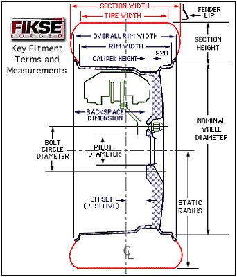

Better than me and describing the situation.
http://www.gtsparkplugs.com/WheelOffsetCalc.html

Probably a different offset wheel. Offset is the depth of the mounting face of the wheel to the hub. The Berlingo wheels are probably a smaller offset meaning they sit more snuggly into the wheel arch, the 206 wheels have more offset meaning they are pushed out towards the wheel arch lip and rub when moving upwards on bumps.
