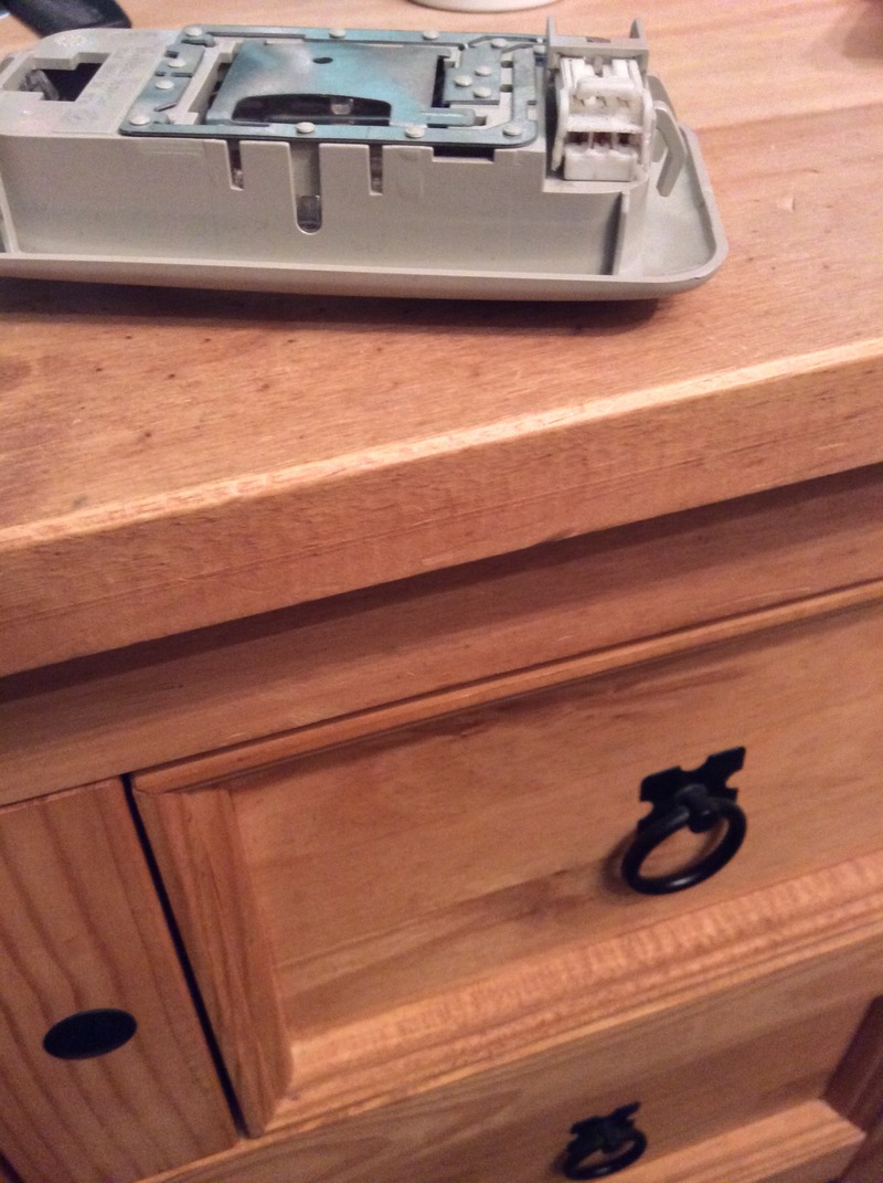

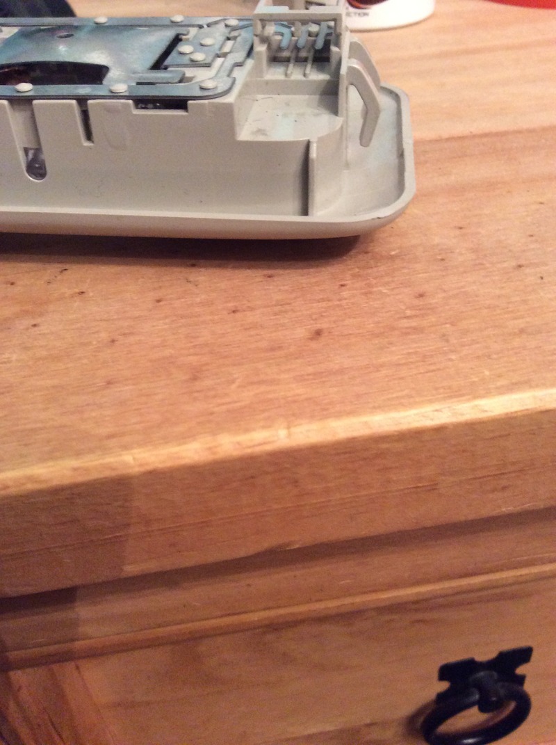

I am trying to source this part which connects into the interior light inside the rear of the van just above the rear doors:
not sure if a Citroen dealership will sell these Separate from the actual light or as a whole unit inc the white 3 way connector block?
Any help to where i can buy these from inc the brass connectors/terminals would be great!

Pretty sure that will only be available as part of the loom. Only option would be get one from a scrapper and graft it on, or see if an autosparks has got spare pins that they could graft back into the plug.

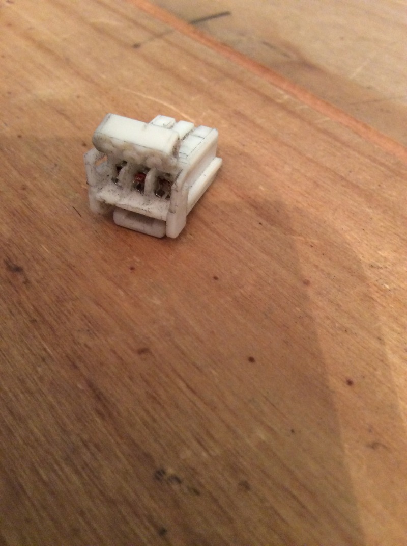

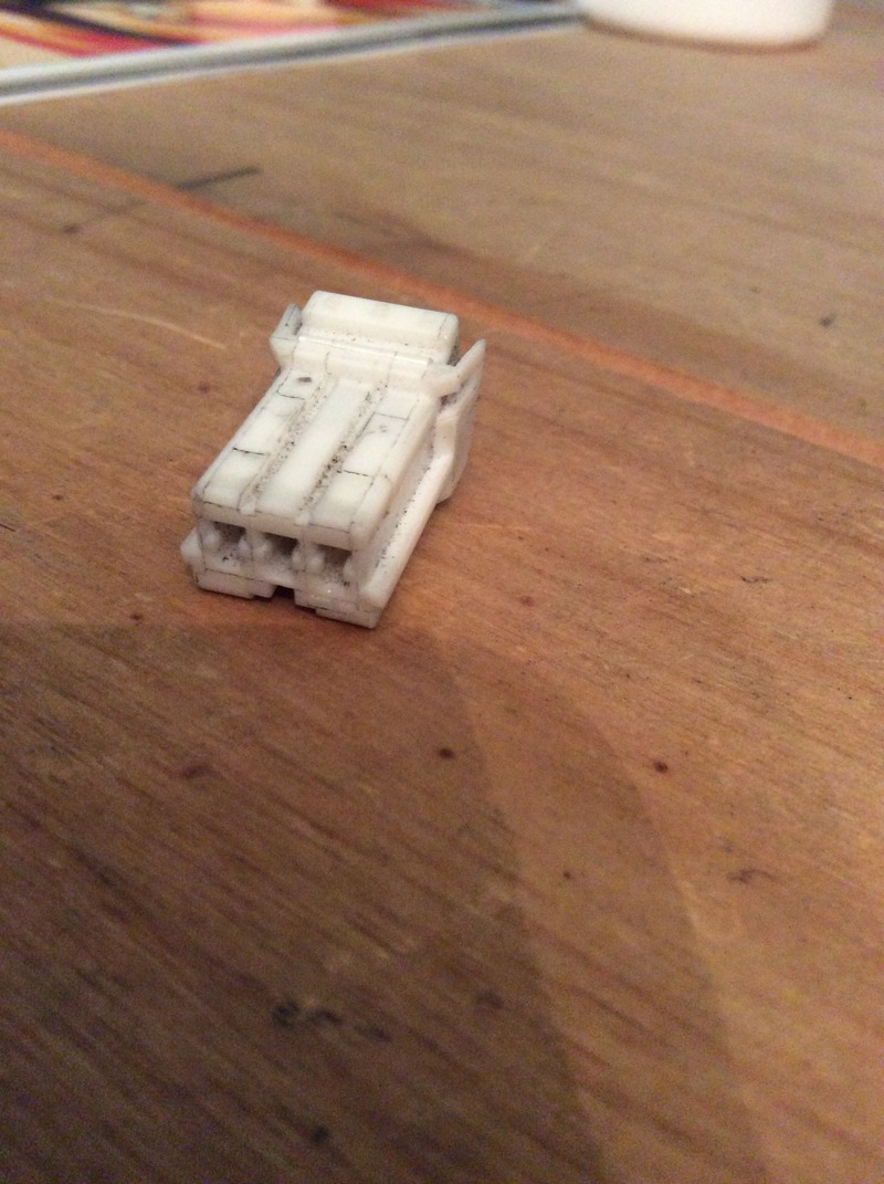

Ok, thanks for the reply. I went to a local citroen dealership and they couldn't offer me any options part from buying the whole 'harness' loom for £56! Do you mean by the brass connectors and graft them back into the 2nd hand connector? I've tried removing the existing connectors out of the existing connector and doesn't seem possible? How do you mean graft it on? Thanks

I have sourced a brand new 3 way multi lock row plug housing connector from an online supplier like for like...so hoping to purchase a couple tomorrow with a few internal connectors too. Will I need a special crimping too also?
