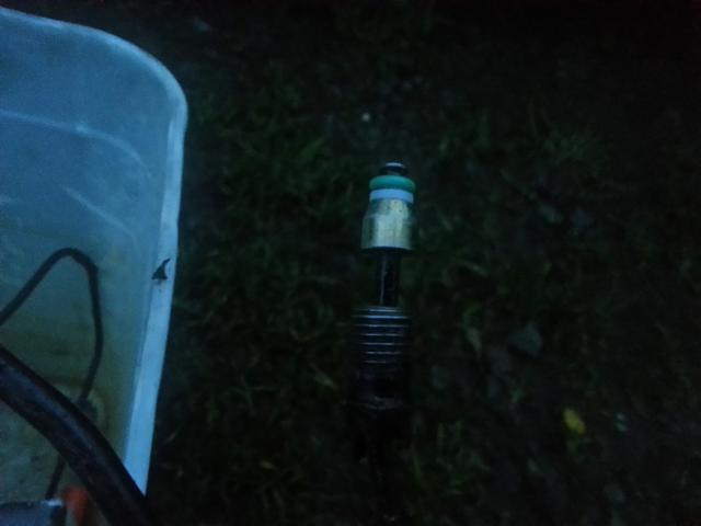

The c5 does not actually have seals like the ones we know and love on xantias for pipe connections..
That is an actual c5 pipe.. its a rear strut feed pipe connection...
