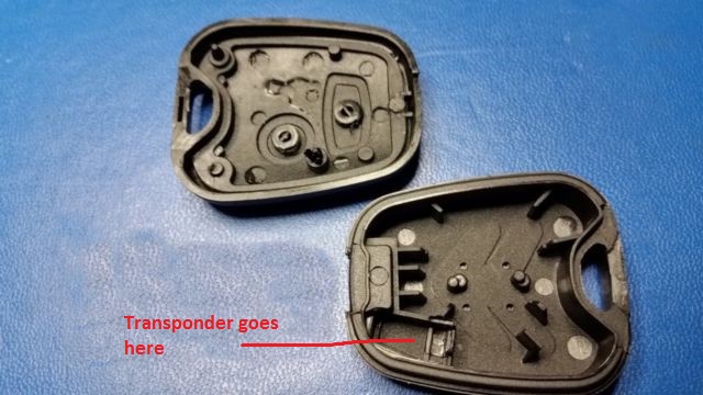

If you can post up a picture of the key somebody should be able to identify where the immobiliser chip is.
Northern_Mike
Re: XSARA PICASSO CENTRAL LOCKING
Does it look like this?
If so, the transponder is a very small, black piece of what looks like plastic. You need to get something small and sharp to pop it out and put it in the replacement key.

yes thats the one! but i use the old fob minus the battery and circuit board in the ignition to start the car...does the transponder need power from the circuit board and battery thats in the fob?? has the transponder stooped working because ive taken the circuit bord and battery out of the fob???
if i dig the transponder out my old fob,put it in the new one one change the key blades over will i have to 'teach' my car about the new key/fob combination? think its something like insert the key turn one 'click' then hold down the lock or unlock button on the fob for 10 secs? bit wary of changing things too much without advice as its semi working at the moment although not quite right!!

No you won't. I got a new key cut for my Berlingo which uses the same key. I simply swapped the circuit board and the transponder to the body of the new key and it all worked.
I didn't realise the transponder was separate from the circuit board either. I found that if I could start the car with the new key if the old key was in the car with me. I had to call the key supplier and complain their key wasn't working, that's when I learnt about the transponder and it's location/operation.
