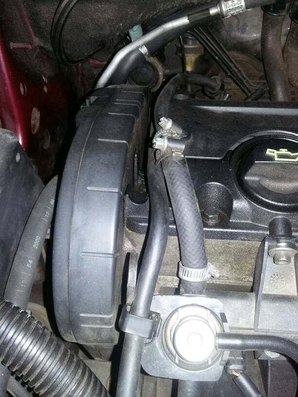

Are you refering to this onearkweld wrote:Had this before , one of fuel hose line clips intermittently gushed fuel on the engine , can't be more specific about the location was a Xantia 2.0i . On & off , unnoticeable on occasions but eventually spotted . The hose clip replacement sorted . Wouldn't have thought it uncommon to smell whilst topping up .

Petrol was leaking from these clips before and replaced but still geting the smell on and off.
2000 Xantia 2. 2.0i 16v

The pipe clips you are using are the wrong type as they pinch the fuelline hose & can cause it to leak. You need the type that has a band that goes completely around the pipe.
I'd also treat that braided hose with a bit of caution. Is it petrol proof? It also looks too big in diameter to fit onto the unions tightly. Dont forget, the fuel is under considerable pressure so all the joints need to be nice & close fitting.
As you stated that you get a fuel smell when you fill up the tank, I'd suggest looking at the screwed locking ring & gasket that hold the fuel pump into the tank. I have seen these fitted with the gasket floating in the tank or the locking ring fitted so its cross threaded.
If the smell is worse when you're running AC, as this is recirculated, filtered air in the car, the source of your leak maybe from this tank fitting. Worth a close inspection.
