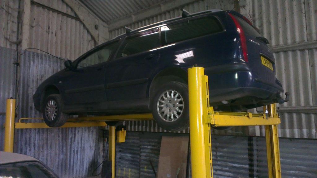

This will be the first use in anger of what I've been installing over the last several months - makes it slightly easier than rolling around the drive in the rain ;-)

Sweet, nice set up....drat, just seen your to far away :)
puts my recent purchase to shame :(
In my workshop the roof is to low so these are as high as I can go.

There's quite a bit more aggro that goes with tnstalling the four poster than with those drive on tipping ramps you've picked up though stickyfinger - if I'd gone with those, it would have saved me months of hassle and a not insignificant amount of C40 concrete and personal labour, so don't be too overawed. You'll be in action with them far quicker than I was with this! :-D

But still jealous, you have made a great facility there.
