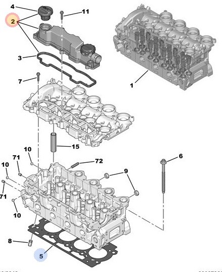

here is a photo of the lay out of the engine, im thinking of just using instant gasket to go around the whole thing before putting it back on

Re: 1.6 hdi oil leak between cylinder head and cam carrier
Unread post by RichardW »
That's how it's supposed to be fitted. Use a small bead of RTV silicone all the way around - you need to go across some of the inner webs as well, and around the injector holes AFAIK. There's a picture of it in the 307 Haynes manual. I doubt that this is causing the rough idle though...
