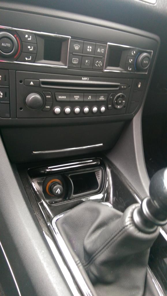

So i've just picked up an 09 C5 Exclusive and the handbook alludes to it having Bluetooth for the phone. If i press the wheel button for the phone the info display says "no mobile connected". Is this a red herring because I can't for the life of me get my phone to find "citroen" to pair it with the vehicle, does this mean its not Bluetooth equipped or i'm just plain stupid?

Can you post the picture of your radio/navigation unit?

RCA in glovebox yes, USB centre console no. Piccy here.....

no bluetooth then....
Some upgrade the head unit, others (like me, have settled) to fit a small bluetooth receiver on the dash just behind the stalk. There are many about @£20-30, the new DAB ones look good as well at @£150.
Its hard wired into the RCA ports with a cable, it has a Mic for hands-free and a line in/sd card as well. I have hard wired the power feed as well to keep the glove box clear.....sigh...another power plug to deal with...
