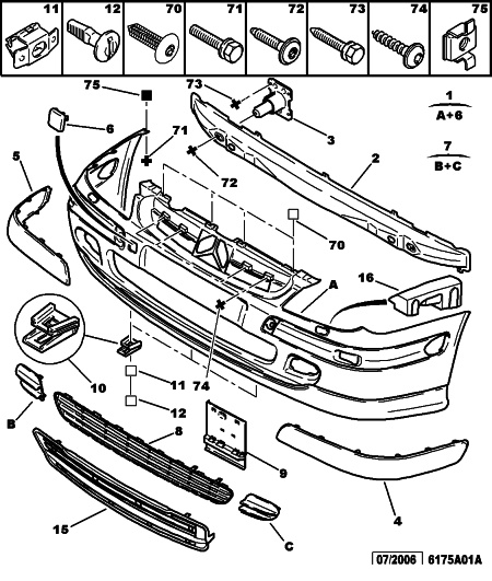

Hi Peter,
Removing the “bumper” is a minor job, I did it two weeks ago.
I had wobbly knees before starting but found that it’s in fact only a cover plate, while the metal bumper is further inside and doesn’t need removing.
There are 11 bolts and "buttons" (item 12) all up; the latter release with a quarter-turn either way and go back in straight ... preferably with a stubby wide-bladed screwdriver.
There’s no proper access by removing the inner wing because the bottle unbolts from the front.
Enjoy a good fiddle.

Hi Clogz, thanks for the post but maybe I'm just get senile in my old age but I can't see half the bolts or buttons meant to hold the bumber on the car, the only things I can see are on the landing panel when you lift the bonnet ... I can't see anything in the wheel arches at all and it's been to wild n wet to lift the car to look with wheels off.
