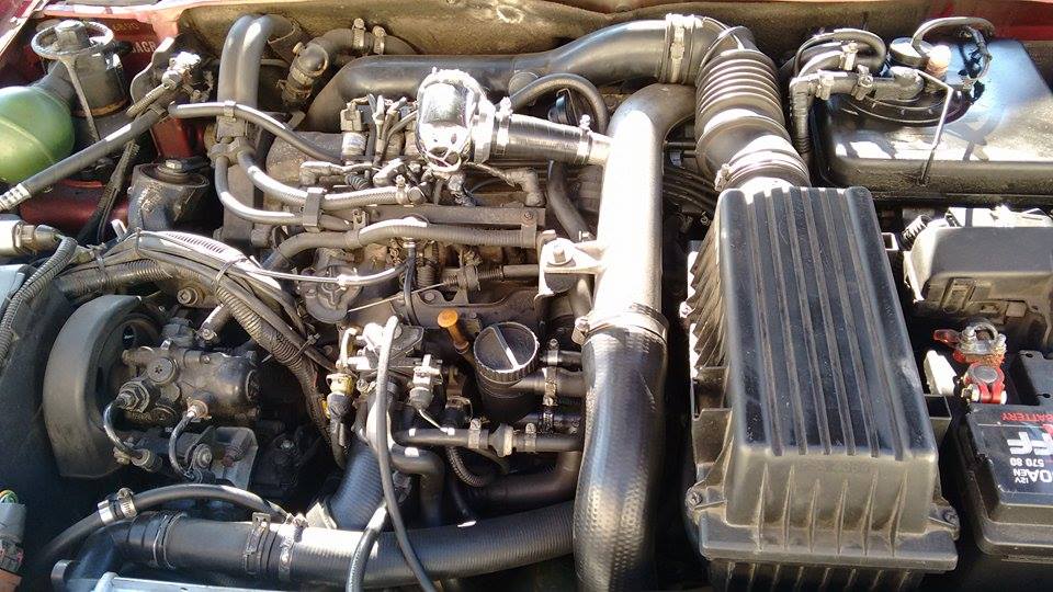

I have a Xantia Activa 2.0 Turbo and for about 2 years the car when goes past 4k rpm on higher gears (3rd and up) then engine cuts fuel and a yellow light appers at the dash.
In these 2 years ive been replacing parts that potencially could cause this issue, i changed the ignicion coil, spark plug leads, spark plugs, the "elctrovalve" (i think the normal name is the factory boost controller) checked every pipe if i had any leak and checked the intercooler also and more and more. I literally changed almost everything 8-[ except the turbo itself and its components (wastegate for example).

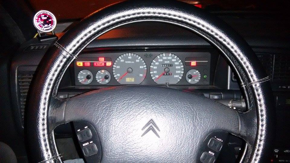

In the last weeks i installed a blow off valve (hks super sqv) and a boost gauge and ive been taking some notes on the pressure.
The car comes to boost very quickly 1.5 rpm 0.5bar and goes to 3k screaming at 1.2bar until it cuts fuel at 4k rpm at 1.4bar!!! (thats 20psi :shock: )
I will post an video here later this week showing the boost gauge at those pressures.
Now i am very worried about this pressure levels, or i installed the boost gauge incorrectly and its giving inaccurate readings (don't really think so this is the case) or im having a serious overboost problem and that explains why the engine cuts fuel at 4k rpm. (i researched a little and learned that this car has a 1bar limiter)

If you are running the standard boost regulator and NOT an after-market manual boost controller then your problem is very likely to be the wastegate vacuum pipe has a hole in it... This will result in no control of boost pressure and the symptom you are experiencing.
The hole (or more likely a slit or crack) will most likely be found at the wastegate end of the pipe. It is not easy to see or check.
Hope that fixes it for you :wink:
