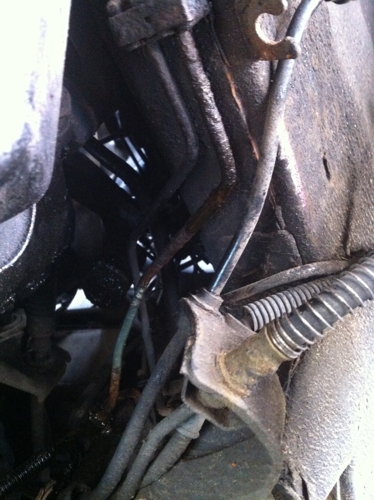

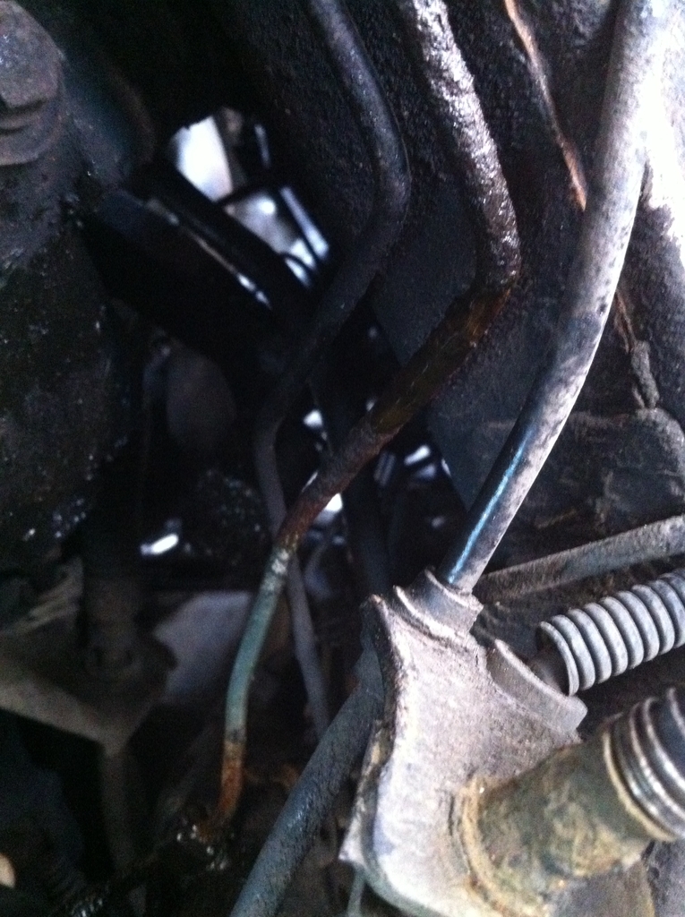

Well a month and a half on, and I finally get some time to have a look and try and source the leak.
Firstly filled the reservoir up with LHM, and proceeded to spill a load just to make sourcing the leak even harder, or so I thought.
Wheel off, inner wheel arch liner off, and car started. Leak right in front of me where it "curves" , spraying right out the corner.
Anyone got any advice on the best way to repair/replace the affected pipe. (Bearing in mind, total novice at the majority of this, but willing to have a go)
Not sure if its clear from pics as closeup, but its n/s front directly above drive shaft.
Thanks again
Dave

Re: Xantia - LHM Leak, Located now got to repair
That's almost certainly the PAS feed pipe - a well known weak point, and a complete PITA to repair. First it runs in one piece from the pump to the PAS pinion valve, via the 'wrong' side of the car and second it's got a rubber section in it to damp out the pulsations from the pump - so it cannot be replaced with just metal pipe. Poster on here was advertising the rubber section, but you still need to get the metal bits and fit it - http://www.frenchcarforum.co.uk/forum/v ... =7&t=49073" onclick="window.open(this.href);return false;

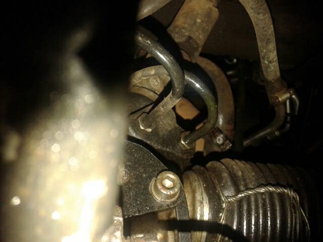

This pipe was leaking in my car. Is it same issue with yours.
excuse me butting in....but what the heck is that twisted bit of wire there for ?? that is a good way of destroying a gator very quickly. Can you not get a clamp that will not cut thru the rubber ?
Chetiya Dias
- Posts: 96
- Joined: 22 Aug 2014, 07:42
This was as I bought the car. Now its fixed[SMILING FACE WITH OPEN MOUTH AND TIGHTLY-CLOSED EYES]Stickyfinger wrote:excuse me butting in....but what the heck is that twisted bit of wire there for ?? that is a good way of destroying a gator very quickly. Can you not get a clamp that will not cut thru the rubber ?
