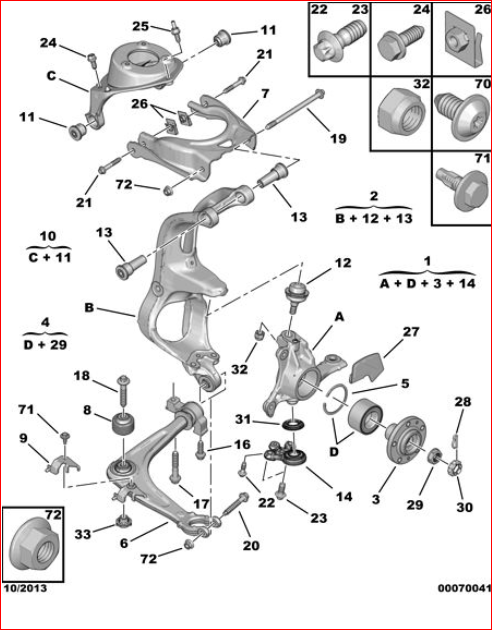

I have the parts Cit Service 70041....parts 31/14 and the huts/bolts

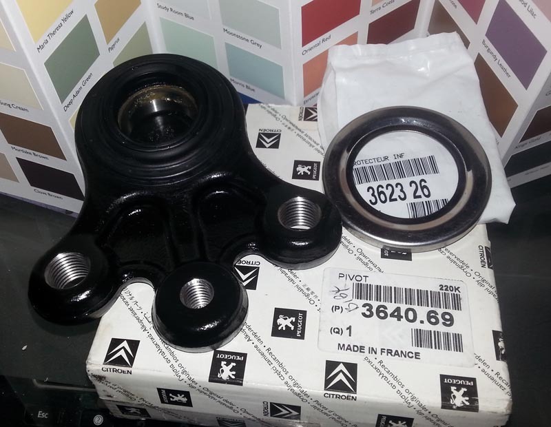

Got the new parts.....note the new shield washer as well. It will be interesting if these are fitted to mine, more likely not considering the Very Poor Standards at HARTWELLS in ABINGDON Oxon.
FYI, there is plenty of room under the rubber and in the bearing for more grease, should I pack it and what type should I use ?

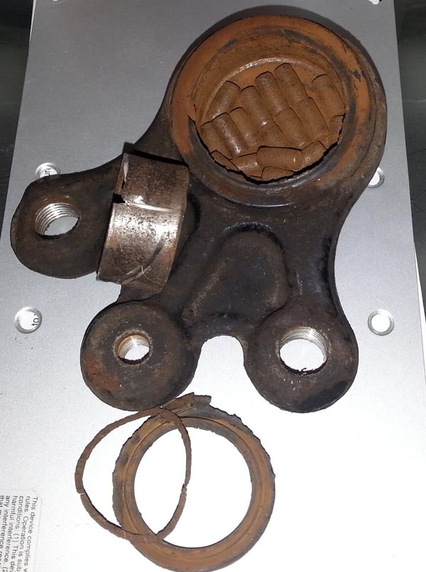

And this is what I found....no sign of the protective collar, two buggered E Bolt heads (well done HARTWELL Abingdon you really are rubbish) totally rounded to which I welded an old socket and got them off that way. Lucky for me the small center one was ok.

That's exactly what I found! Minus the buggered bolts. Nice one, hope it goes back together ok, I used a big hammer and block to seat the new one, though a bottle jack might help.

A nasty mess! Thinking about your post above re grease - don't overdo it, as you risk hydraulicing it as you drive it home. God only knows why they use E-spline bolts - they always seem to be a poor fit to me. Did you manage that on the car, or did you take the hub carrier off?
