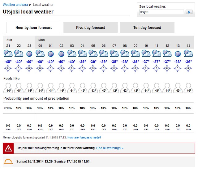

Thanks, No complains, everything is fine. Getting warmer day by day ...myglaren wrote:How are things in the frozen north?
and also brighter day by day (note the sunset and sunrise date/time at the lower part of the pic.)
Edit: myglaren, replying to your below msg,
YES, sunbathing whenever it's possible
