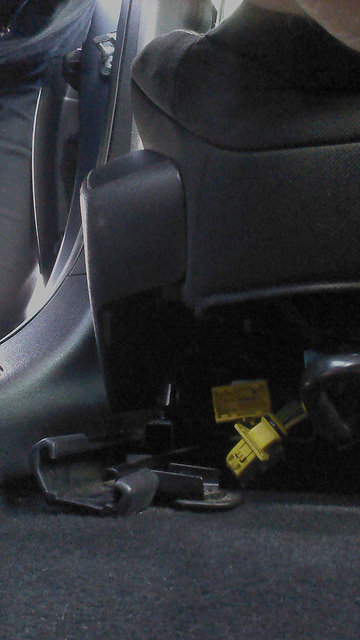

So this weekend I bought a '08 C5 VTR+ Tourer from a dealership, very pleased with it. However upon giving it a thorough clean I found that there was a yellow plug un-done under the drivers seat.
In my previous car this was airbag related so I plugged it back in and started up the car, all seemed fine so I went for a drive and found that I got an intermittent warning saying "Airbag(s) or pretensioner seat belts(s) faulty" Sh*t. Interestingly this warning is never stored in the faults log when I press the check button to the right of the steering wheel. I un-plugged it again with the car off and the warning no-longer appears, which I almost find more of a concern, surely un-plugging an airbag should raise all kinds of hell on the dash?

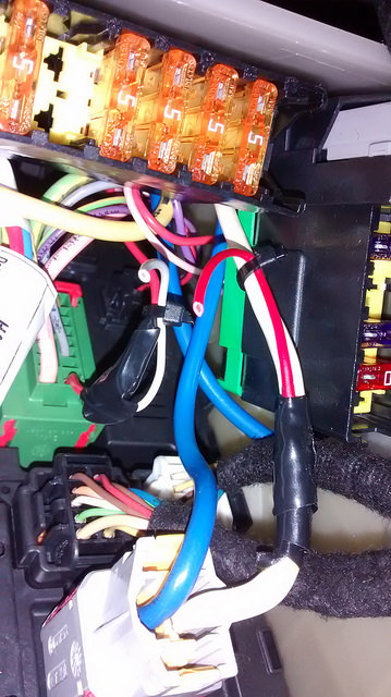

Thanks for the replies so far, I forgot to mention this was a used dealer not a main dealer, hence wanting to go in armed somewhat. Good to know about the OBD readers not being compatible and not to expect much from the CHECK button. I went and nosed at the airbag fuse and in doing so saw that there were two wire ends electrical taped to other wires in the fuse box, looked a bit shifty but I've seen worse factory wiring. Will upload a photo later.

So the first image is the plug as I found it originally:
And in the fuse box, you can see the white and red wires are taped onto other larger wires but lead no-where.

More than likely an accessory such as bluetooth, DAB radio or suchlike was previously fitted to the car and has been removed by the previous owner, I wouldn't be overly concerned about those as long as they are insulated to avoid shorts.jamie_bkc wrote:And in the fuse box, you can see the white and red wires are taped onto other larger wires but lead no-where.
