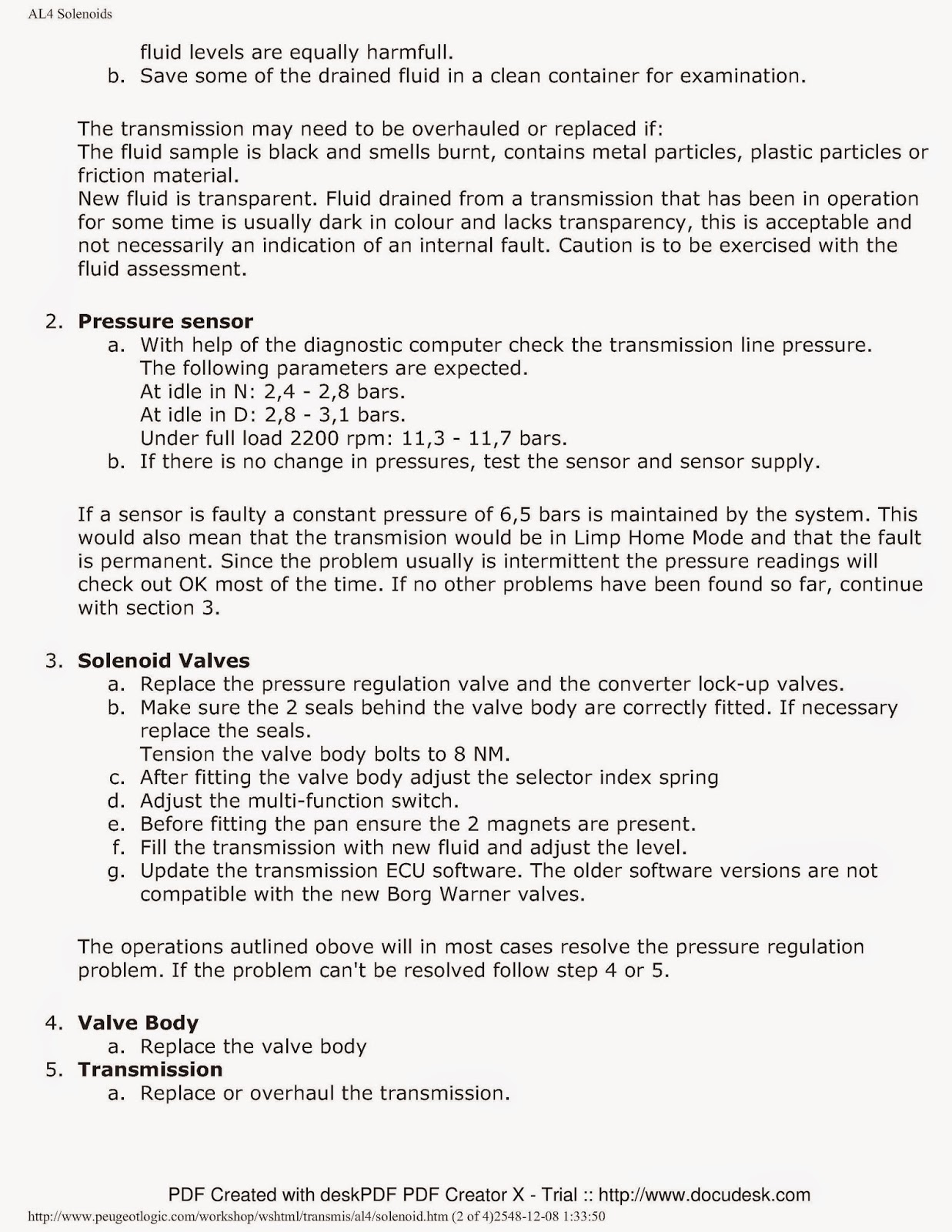

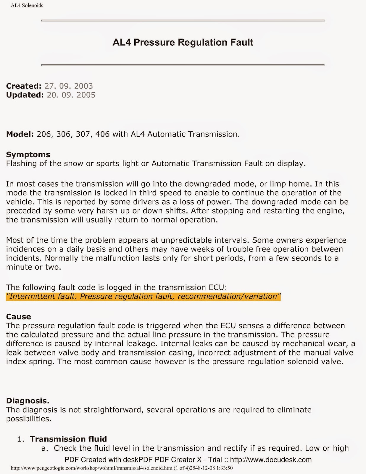

After a while on google, I got this:

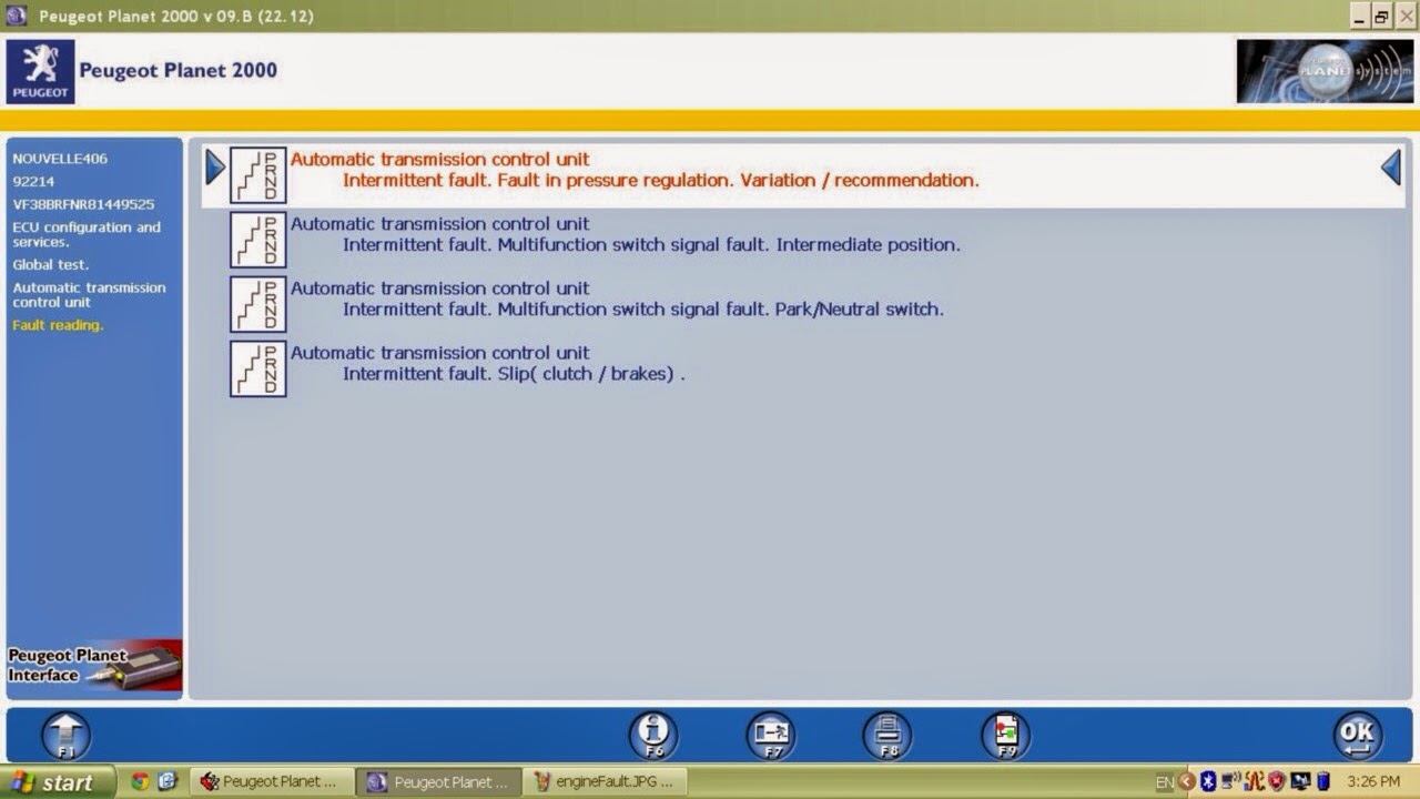

and PP2000 diag got this,
This guy said we need to update ECU software for replacement of 2574.10 to be 2574.16.
(http://my206xr.blogspot.com/2010/06/al4 ... block.html
