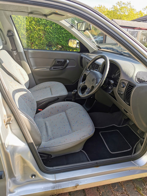

A few days ago the Caddy was given one last clean up ready to move on to its new owner.
Still doesn't scrub up bad for a 21 year old van.
Off she goes.
Has been a cracking little car...van...? I still never quite decided whether to call this a car or a van. Always felt more car like to drive, so I've always tended towards car. I really hope she continues to give similarly Stirling service to the new owner.
This is a big weight off my mind though as it means that all my cars actually can be kept on my own property again rather than having to abandon one around the corner or have one lodged at a friend's house. That takes a bit of the urgency out of moving the P4 on at least.
