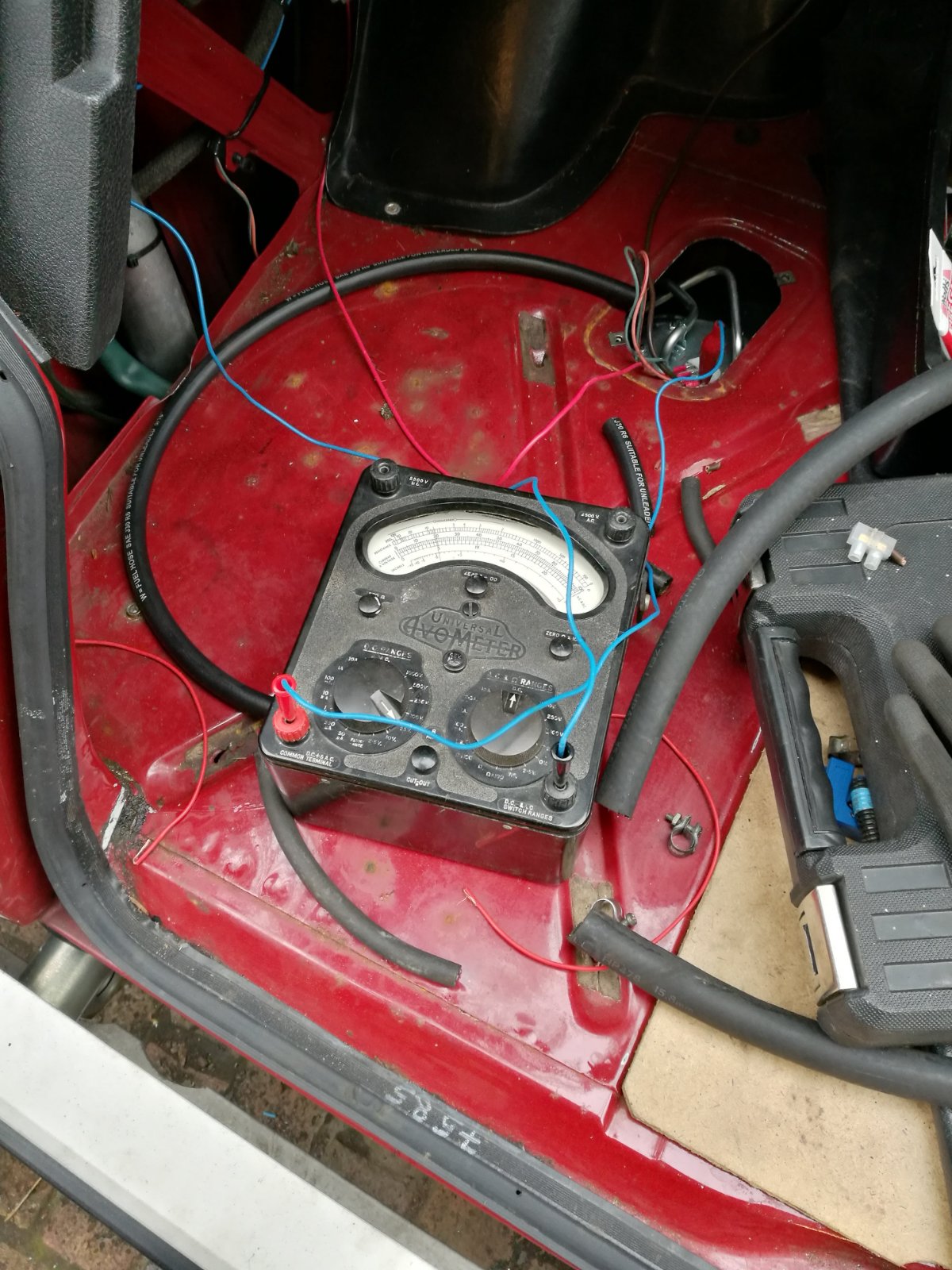

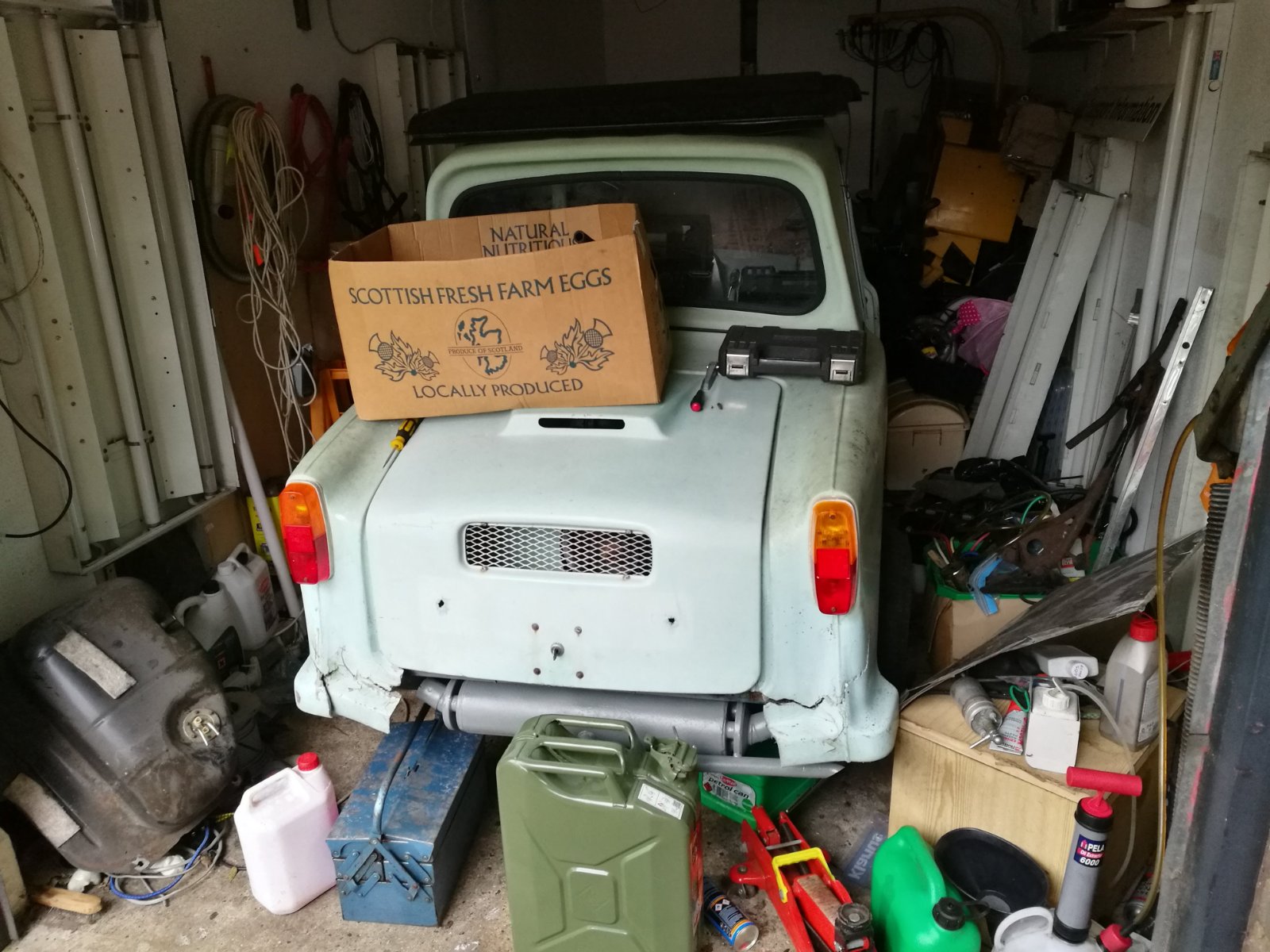

Realised that I've managed to do a very good job of burying the Invacar while getting the Lada's fuel system sorted out. I'll need to dig my way back into the garage at some point this week.
Despite having made an awful mess of the garage, I did manage to get the new fuel tank installation in the Lada properly finished today. Was 95% done earlier in the week, but I ran out of time to get the wiring sorted out. Today therefore consisted mainly of retrieving the wiring originally routed under the car to the old fuel pump and rerouting it via the cabin to the new pump.
I did have to do a bit of detective work there on account to someone having decided to change the type of connector used on the top of the tank at some point. This was made slightly more time consuming when my multimeter for some reason decided to turn itself into a doorstop. Far more confusion was caused by it spending the first ten minutes giving nonsense (but plausible) results, causing me to chase my tail for a while.
Once I figured out that the fancypants modern meter was lying to me and I called in the old standby, things quickly made rather more sense.
Inner two pins are the pump, outer two are the gauge/warning light. Easy.
Connected it up, and glad to report that it just worked "out of the box." Pump is so, so much quieter than the old one (C900 8v one originally), and the car seems to be running better. Not sure if this is because the fuel pressure/volume being delivered is closer to what the pressure regulator is designed to handle or whether in my poking around in the engine bay I've eliminated a couple of potential minor vacuum leaks. Vacuum leaks are the bane of this injection system, even the tiniest one being quite sufficient to cause it to throw a major tantrum. Either way, it seems to be running a good deal smoother.
Still want to tidy up some of the pipework in the engine bay a bit, but that's a smaller job and is more for the sake of tidiness rather than functionality. Hopefully get it booked in for an MOT this week, really looking forward to driving the old crate again...
Will need to think about picking up a replacement for the meter that has apparently died as well...Got a few cheap ones floating around the house, but never really trust them...Have always wanted to add a Fluke to the workbench...Just really can't justify the price for them!

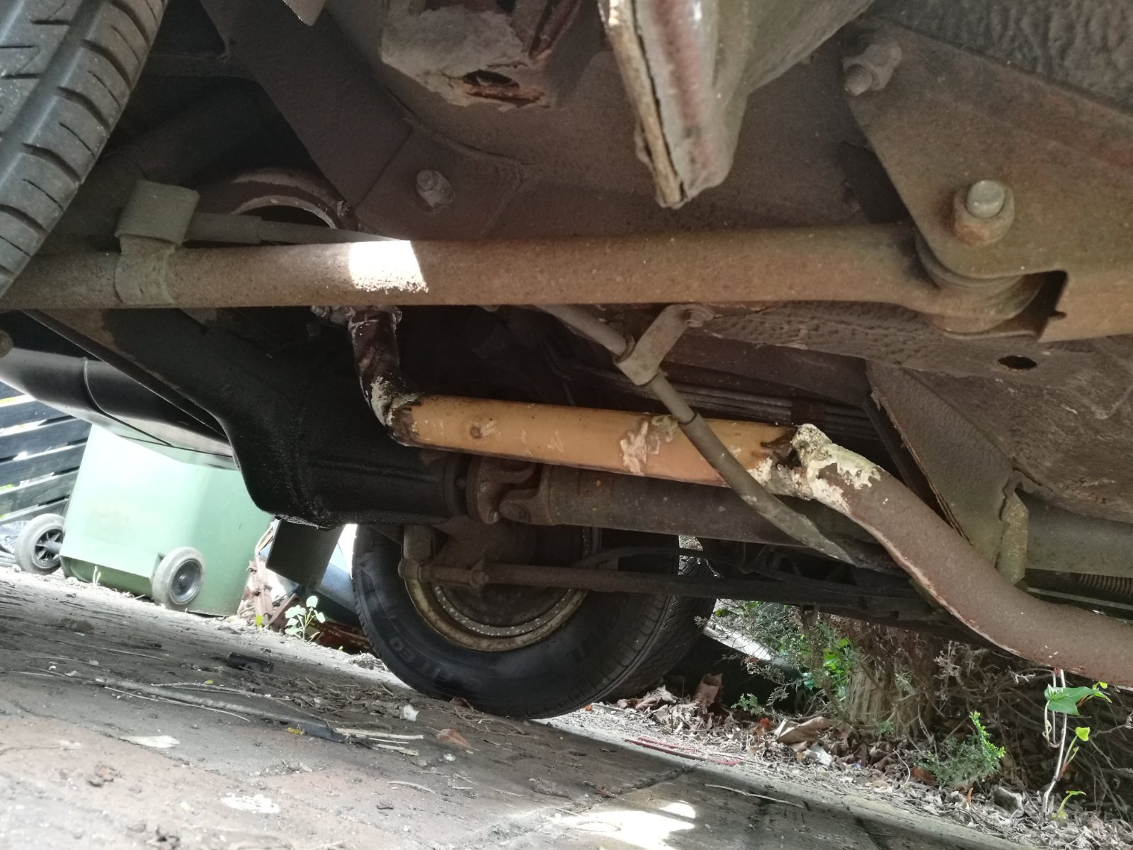

The exhaust is a mess though...This abomination is what I cobbled together when the middle box decided to disintegrate one day. I kid you not, it basically exploded.
I might take it back off and re-do the welds (with a not empty gas bottle this time!) and see if I can at least get it properly gas tight for the MOT. Realistically though, it wants a whole new system from the cat back.
