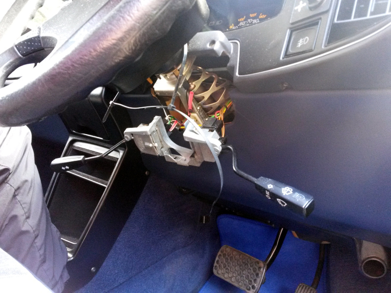

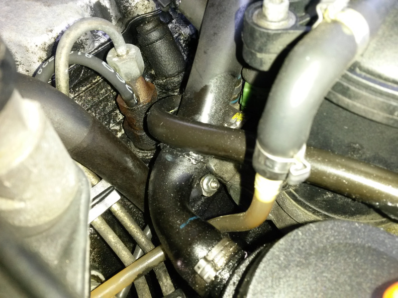

After spending a couple of hours trimming our hedges which left my arms feeling like they were about to fall off, I decided that was an excuse to actually do something *I* wanted to for a change! So attacked the to do list for the cars a bit.
Firstly was the dodgy indicator stalk on the Saab, the replacement for which I found yesterday evening when digging around in the loft trying to find the 3.5" USB floppy drive that I know I tidied a couple of weeks ago. Where I tidied it to however I don't have the foggiest idea. Found a whole host of things I wasn't looking for, including a couple of boxes of discs - including ten 5.25" ones, which is odd as I don't remember packing those...Reason I was after that is because I'm determined to get one of my older laptops back up and running, after it decided to stubbornly stop booting from the hard drive about a year and a half ago. Still reads the drive fine, but refuses to boot from it. I want to be armed with the materials to do a reinstall if necessary, but unfortunately my MS-DOS 6.22 and Win 3.11 discs fell foul of the mould in my parent's house where we had serious damp problems. I do have images of them though (I was at least organised there! ...even if I didn't think to do the same for things like Office unfortunately), but need an accessible drive to actually make the install media. Half tempted to see if I can find a suitable oddball flavour of Linux to throw at it as well if I can find one that's user-friendly enough for me to get my head around. From memory the machine's a 486DX2, has 20Mb of RAM (16Mb of which is on an odd PCMCIA-like but not quite add in card), a 340Mb harddrive and a standard HD 3.5" floppy drive. Networking is currently not possible as my PCMCIA network adaptor appears to have died while it was in storage annoyingly.
Anyway...back on topic, the detent on the Saab's indicators had been getting progressively worse since I bought it, to the extent eventually that if you hit a bump you would suddenly be indicating left. A temporary bodge had been done by wedging a bit of rubber pipe in next to the stalk, though that obviously also stopped the self canceling thing from working, and meant that there was no centre detent.
This was one of those rare jobs working on a car where I found myself thinking "now, that's a really *good* bit of design." Removing either of the stalks involves taking two screws and one clip off, after which the whole lower steering cowl comes off. Two more screws release the cradle to which the stalks are attached. Then another two screws and a few connectors release the stalk itself. Refitting is simply the reverse of removal. Whole job took about five minutes end to end.

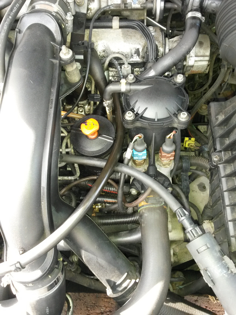

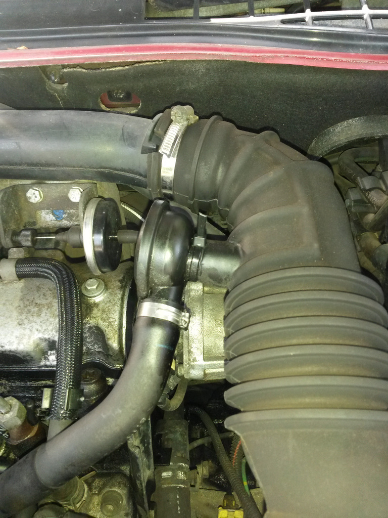

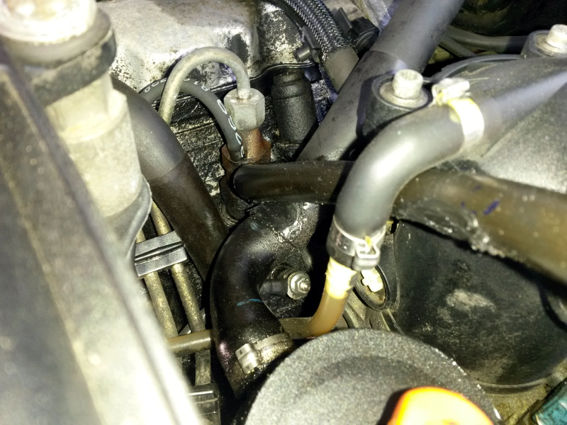

I then decided it was high time that I actually investigate the bubbles I noticed in the clear fuel line on Sunday (when revving the engine, nothing at idle, and it's not draining back to the tank).
The primer bulb goes hard after a couple of pumps, and despite a good prod around I couldn't find any signs of fuel seeping out around the filter housing or anything, despite some obvious chafing of a couple of hoses where they've been vibrating. Not least next to the dipstick tube because that clip has broken, and the PCV hose which it's made quite a nasty dent in.

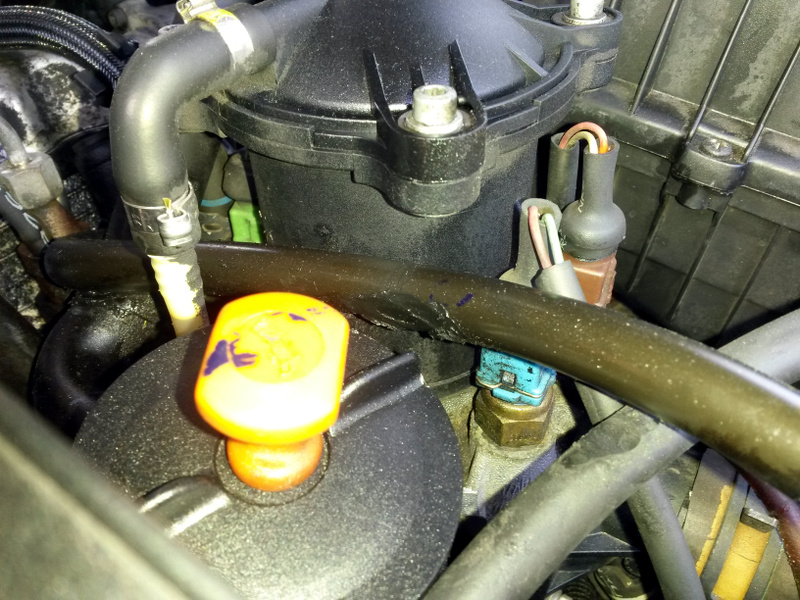

I also spotted this bodge...Proper hose clip will be going on there probably tomorrow.
The PCV hoses appear to have turned to plastic over time as well, there is absolutely zero flex in any of them, meaning that the normal hose clips aren't really doing anything resembling a good job of securing them. Is that normal, or would I be better of just replacing them, assuming that they don't cost a small fortune anyway.
Can someone confirm what the correct "layering sequence" for this general area? The way things seem to want to sit, the throttle cable should actually be above the fuel supply line rather than under where it is just now? Not sure whether the wiring to the blue Bitron sensor should be squidged underneath things, or looping over the throttle cable.
In the meantime I've slipped a bit of old heater hose over the fuel hose where those two meet and have cable tied them together so they can't rub any more. Likewise the fuel hose is now clipped (well...cable-tied) where it should be to the oil filler/dipstick housing. I also routed the water drain pipe via a little clip on the dipstick housing (for which I can't see any other use?) so that it sits over where the oil filter is now - so that I can drain any water into that while my oil drain pan is under the oil filter to catch the inevitable spillage when it's changed.
While I was in there, I also cable tied a bundle of other bits of plastic and pipework in place which were flapping around in the breeze (and vibrating madly when the engine was idling). I never would have thought that a few cable ties could reduce mechanical noise that much!
Never did find where the air leak is though...however, today when the engine was revved it stubbornly refused to show any evidence of air bubbles...Looks like we've got an intermittent fault to play with...oh joy...Pretty sure that this will prove to be linked to the slightly lumpy power delivery, especially on light throttle though. Time to get me some clear fuel hose I think and insert it at key points along the run back to the tank until we have bubble-free fuel flow.
Have also ascertained that the timing cover gasket is utterly stuffed, which is where 90% of the oil seems to be coming from. A job both the Xantia and Saab need done then...I'd put money on it being easier on the Saab...don't need to dismantle half the car first there to get at it...
