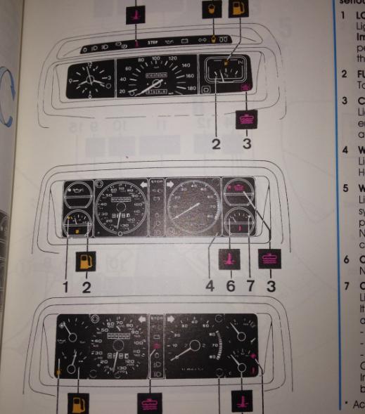

The length is due partly to some models (XS maybe) and certainly GTi / DTurbo / STDT which have a tacho and the speedo is not in the middle its on the left.
There might be a difference between early and late (say 87 or newer, when they changed the dash layout a bit) as well.
Its quite a tight fit anyway, there's little to spare.
Andy.

Thanks for that info. Ill try to tell the pug dealer the part numbers.
This car is another victim of the whole 1990s west-coast RHD trend BTW, but I have no idea where it originally came from. Most right-handed cars that end up here are from Japan, but I dunno if they ever sold 205s there. I think UK-spec 205s were made in the UK and have different ID plate (is this right?) so this one is probably not UKDM, but to be honest, nobody knows. Its got orange turn-signals and un-colored front parking lights inside the headlamps, European-style.
Its a mid 1990s car, so way past the redesign in the late 80s. 2 doors, aftermarket sunroof, no trim at all but i guess it was de-trimmed.
Anyways, it has a normal late 205 tranny (be5?) and it has the most basic kind of dash, the one shown right at the top of this photo:
So does anybody happen to know which dash needs the longer cable? Do the two styles with the speedo to the left and a tacho need a longer cable? Or does the cable come in from the left, and therefore actually the type with the center speedo need the longer cable?
Because this car has the dash with the central speedo, but who knows what it would have had originally.
If the central speedo type needs a SHORTER cable, than we got lucky, cause the shorter 900mm cables seem to still be avaliable. But if the left-speed type need the shorter cable and the central-speedo type need the longer 1100mm cable, than not so lucky.

Unread post by spider »
To be honest I'd be tempted with the longer one, I'm pretty sure the end fittings are the same.
I do recall you have to feed it one side of a bracket or suchlike to get it to fit, the non-tacho vs tacho models have it one side or the other if that makes sense.
As far as I remember basically there were two facelifts, one about 87*** when the dash changed (basically round heater controls instead of up/down sliders) and again about late 90 early 91 I think. The second facelift is easier to spot, as the reverse lights changed to be in the bumper (along with the fog light, ie one fog one reverse) , this is the time the front indicators went to clear as well. Although the issue is, all these parts are easily swappable between models.
*** The speedo changed at this dash facelift as well but it was just the font on it (smaller numbers on newer ones) nothing else changed regarding the cable.
The driving school cables are not relevant iirc they are for LHD vehicles typically as new models 206 etc have these type of parts for switchgear too.
Andy.
You know, I was thinking about this a moment ago. Short may be LHD and long RHD.
If you think about it, its not like the 106 or something where it always enters on the left of the car, the RHD cable is longer as it must go across the bulkhead and enter near the servo area, so a LHD cable *will* be shorter.
Same way a LHD clutch cable is tiny in length compared to a RHD one (as its more or a less a "straight line" on the LHD)
Andy.
