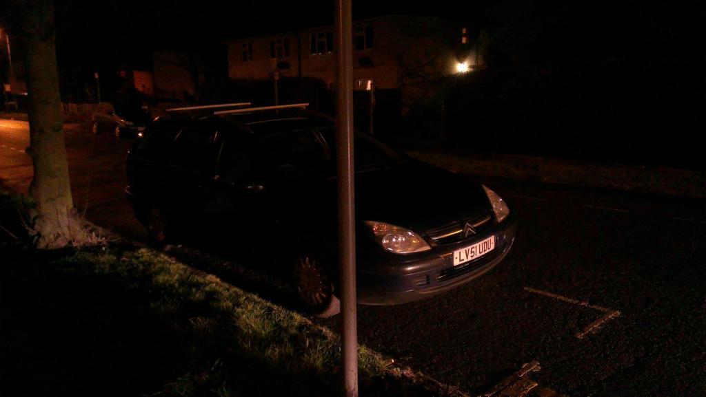

My Safari is a long, long, long way off being on the road, so went and bought this today;
(difficult to photograph a dark blue car in the dark :lol: )
2.0 HDI (110 bhp) 151k, MOT till Sept, very little service history but I know when the cambelt was last done and it's not due another service for another 10k (last one at Wolsley House Motors, when it had new front pads, discs and particulate filter). It's also had a new exhaust since then.
LX but with hydractive3, brand new rubber boot floor liner, tow bar, genuine locking Citroen roof bars.
It also has new wind deflectors all round.
It was up for £800, I gave £650.
